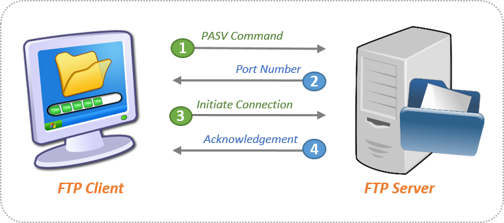

Primarily, the command channel is opened by the client to the FTP server on port 21. The client also opens two random, unprivileged ports on the client (typically a port greater than 1023). We’ll call the first port P and the second port P+1. The FTP client initiates the connection to the server by sending a PASV command. The client connects to the server from port P to server port 21 with the PASV command. The server then opens another unprivileged port Q (any port greater than 1023) and sends the port information back as a reply to the PASV command. Now the client initiates the connection from port P+1 to port Q on the server to start the data transfer.
Steps:
  1. The client contacts the server using the PASV command on port 21.
  2. The server replies using port 2000. Here, port 2000 is the port the server will be listening to for the data connection.
  3. The client initiates the connection from port 1025 to 2000 (on the server).
  4. The server sends back the ACK (acknowledgement).

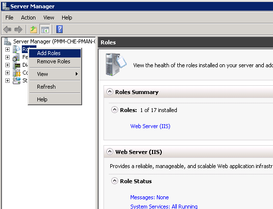

  1. Navigate to Start > Control Panel > Administrative Tools > Server Manager in Windows Server Manager.
  2. Go to Roles node. Right-click on Roles and click Add Roles.

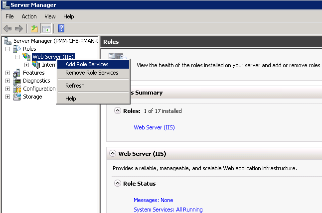

Enabling FTP in Windows if IIS is already installed as a web server
  1. Navigate to Start > Control Panel > Administrative Tools > Server Manager.
  2. In the Windows Server Manager, go to Roles node, and expand Web Server (IIS).
  3. Right-click on Web Server (IIS), and click on Add Role Services.
  4. In the Add Role Services window, go to Roles Services, and check FTP Server.

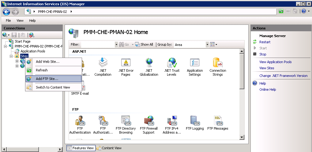

Setting up an FTP site
  1. Navigate to Start > Control Panel > Administrative Tools > Internet Information Services (IIS) Manager.
  2. Once the IIS console is open, expand the local server.
  3. Right-click on Sites, and click on Add FTP Site.

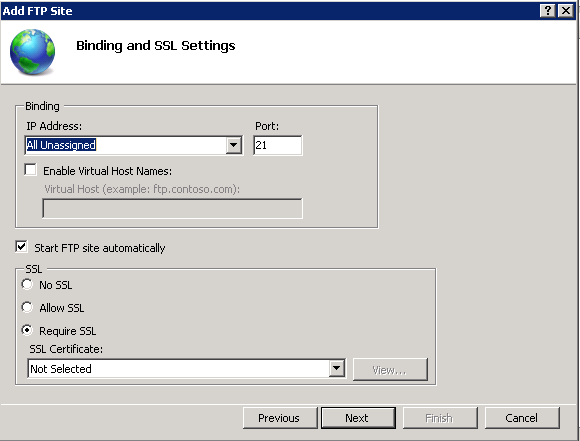

  5. In the Binding and SSL Settings window, type the IP address of the server. Check the Start FTP Site Automatically option. Choose SSL Based on Constraint. Click Next.serv-u-features-windows-setup-ftp-setup-windows-image-8.png

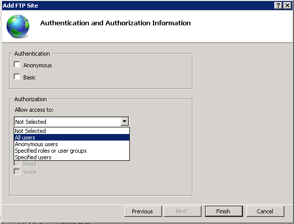

  6. Now, select Basic for authentication.
  7. Click Finish. Now, the FTP site creation is complete.
How does FTP basic authentication work?
Basic authentication means there’s no encryption used. Thus, username/password are sent in clear text. Basic authentication matches the username/password from the Active Directory database. You can also create accounts in IIS. This can be done from under Management Tools in Web Server (IIS) role.
Under Authorization, you can select All Users to allow FTP access to all users from the domain. Also, check both Read and Write under Permissions Based on Requirement.

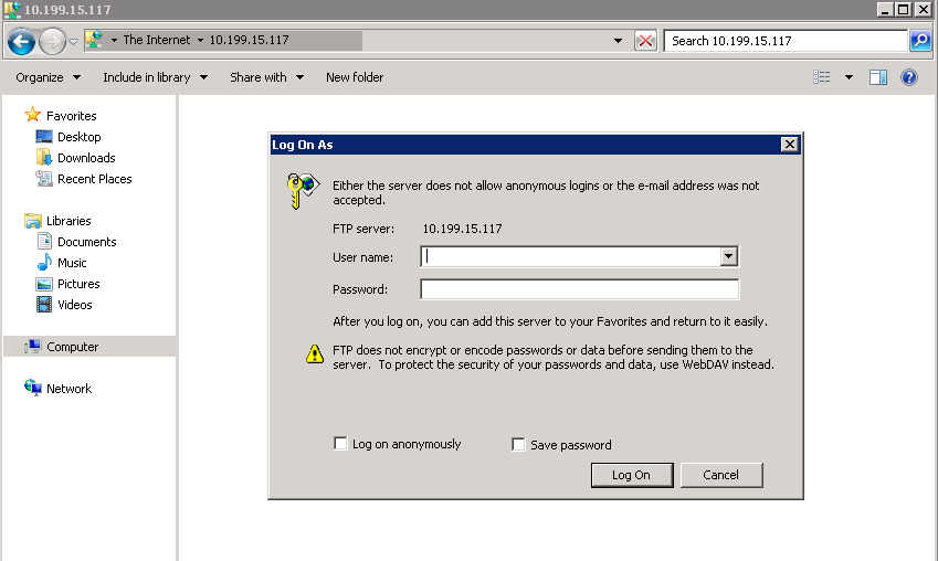

Accessing files on the FTP server
To access files on the FTP server, open a file explorer and type ftp://serverIP. The FTP server asks for a username and password. Enter the username and password (Windows or Active Directory credentials) and click Logon. The files and folders display under the FTP server.
