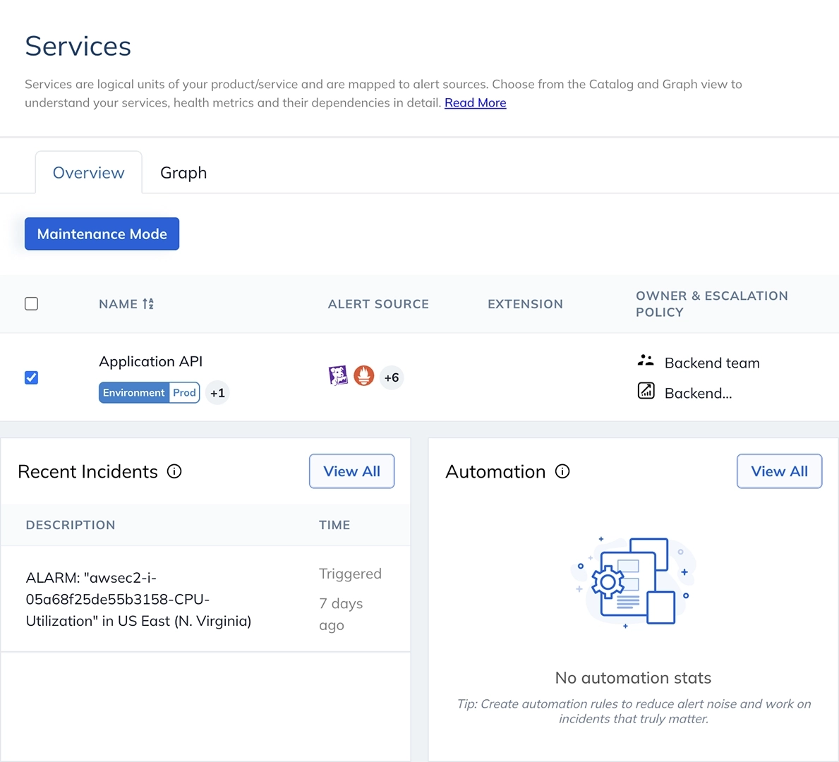

A service catalog is a central repository of information for the systems and services managed by SRE teams. Service catalogs can document various components of a system or service and track their status and availability.
Some of the information an SRE team’s service catalog might contain include:
- A list of systems and services supported by the SRE team and owned by development teams
- Detailed documentation of the components and dependencies of each system or service
- Performance and availability metrics for each system or service
- Service level agreements (SLAs), service level indicators (SLIs), and SLOs for each system or service
- Contact information for the team members responsible for managing each system or service
- Escalation plan for incident response
Service catalogs can be created and maintained using various tools and technologies, such as documentation platforms, service level management platforms, and configuration management tools. By using a service catalog, SRE teams can create a comprehensive and accurate record of managed systems and services, which can improve reliability and availability.
An example service catalog implementation (source)

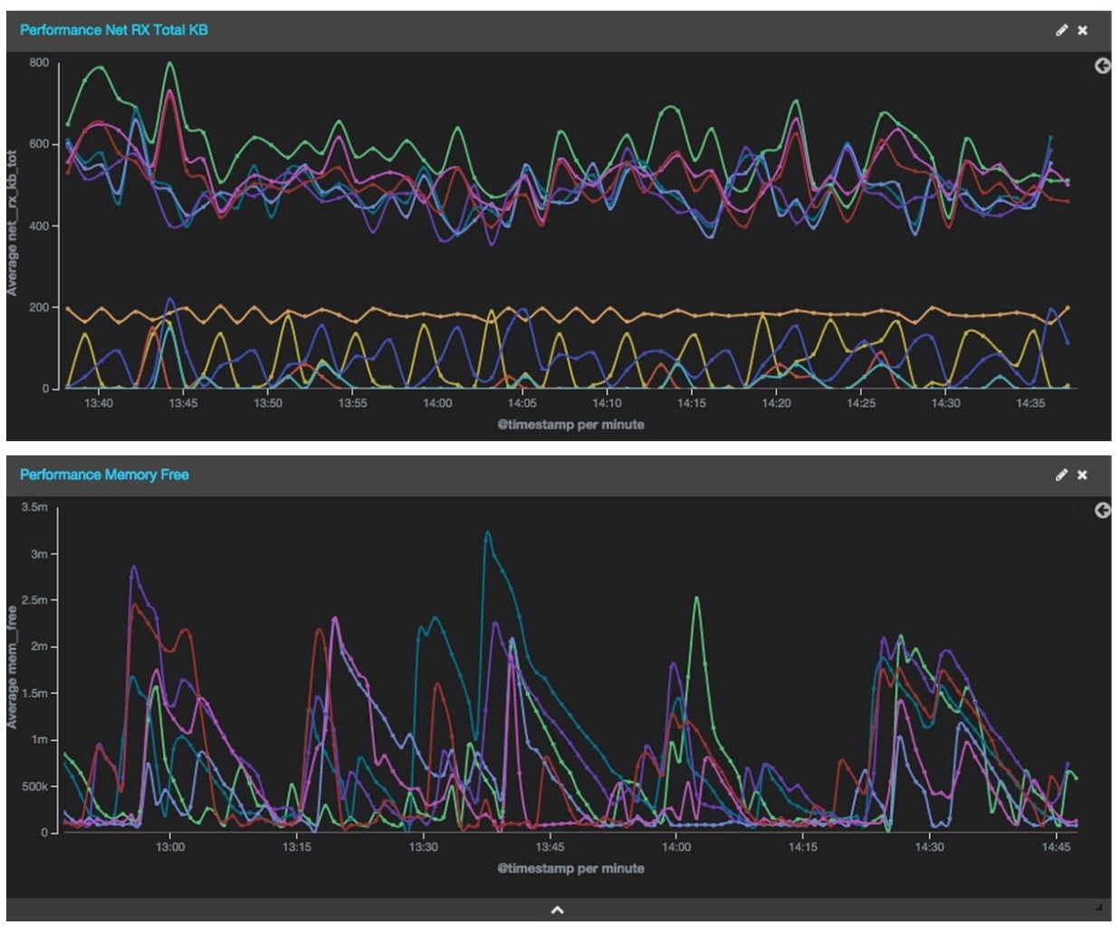

Log management systems enable engineering teams to collect, store, and analyze log data from their systems. Log data can include error messages, warning messages, and performance metrics.
Examples of performance metrics (memory and network) in Kibana (source)
Log management systems provide a centralized location for storing and accessing log data and can be used to identify trends and patterns in log data, as well as to troubleshoot issues and perform root cause analysis.

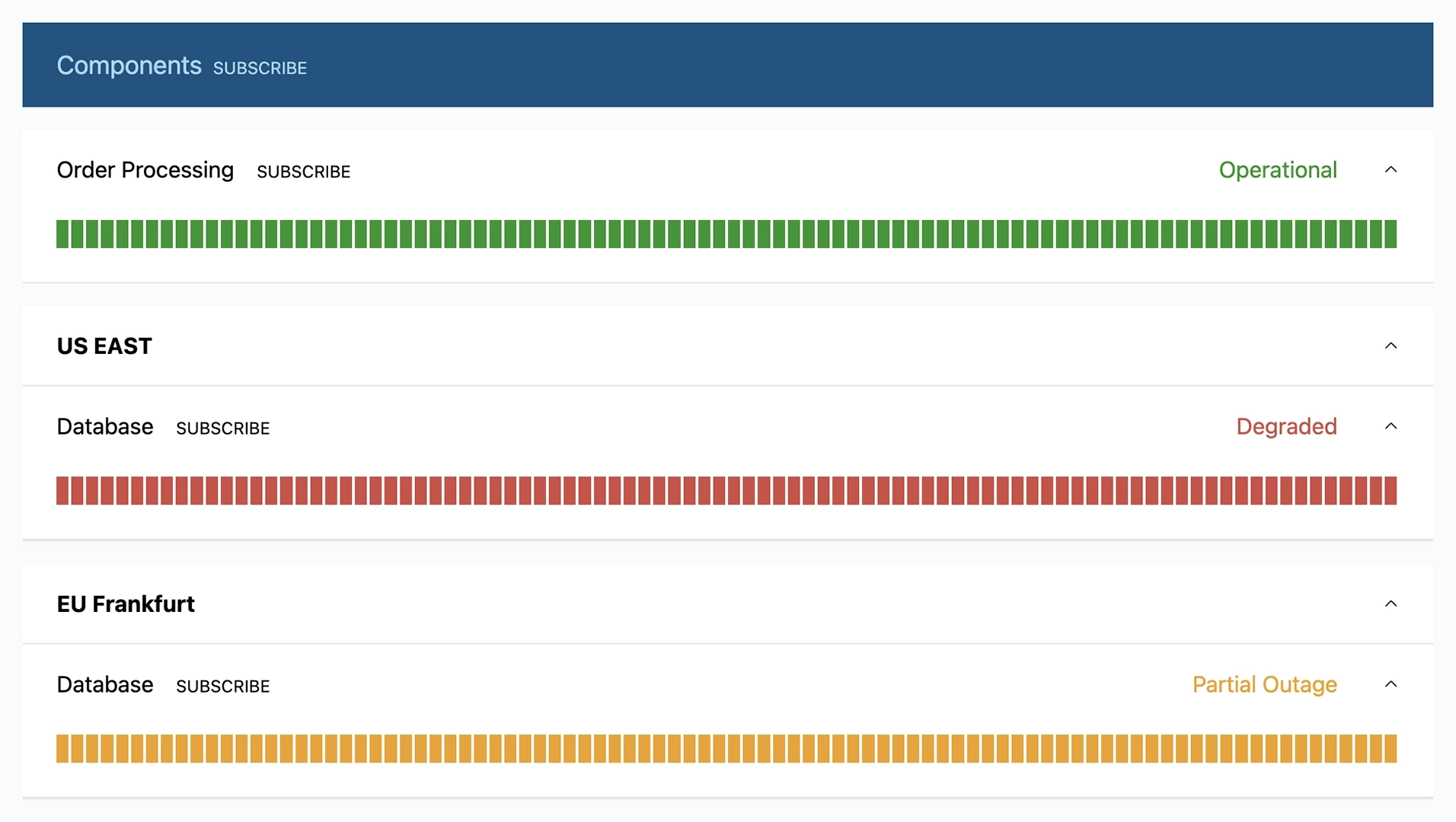

A status page is a web-based platform that provides real-time information about the status of a company's services. It is often used to communicate the current state of a company's infrastructure, applications, and other systems to its customers and stakeholders. This page must show accurate and timely information.
Typically, support staff manually updates this page to display the system status to customers. A status page can be connected to SRE tools and health monitoring systems to automatically update when a critical component fails. Minimizing manual work as much as possible while maintaining high accuracy is imperative for maintaining the status page. Alerting systems must be accurate, and a careful selection of both private and public alerts that represent the health of the selected components of the system should be connected to the status page.
Historical trends regarding the health of these critical components should be provided so that customers can see the system's reliability. A few of the available tools for Status Page management are Squadcast, status.io, and Altassian Status Page.
