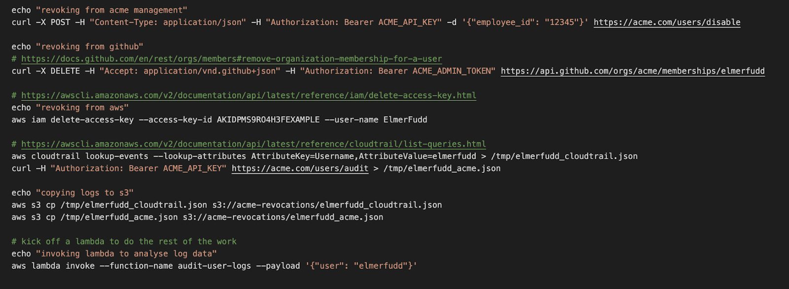

Automating the Runbook
This simple example of a runbook requirement may seem trivial, but even a small mistake in executing the actions could lead to disastrous results. The phrase “I’m only human” is common. Humans make mistakes. That's an inevitability that should be taken into account when creating runbook steps. Screenshots or diagrams to accompany complex instructions can help, but automating the task is ultimately the most reliable way to ensure a predictable result.
Let's break it down step-by-step, using the example above, and see how to automate the process using a script or set of scripts. The task details would  become simpler and point the reader to the script(s) to run, explain how to run them, and advise how to validate their success.
  1. Disable their user account for the internal system: Most modern web applications will contain a REST API that can be programmatically invoked via simple scripts. These scripts can trigger most actions (potentially more) than those via the front-end user interface. The start of our automated solution would involve a call to an API to disable the user’s account.
  2. Disable their GitHub account: GitHub is an example of a web application with such an API. Similar to step one, our script can make a call to the GitHub API to remove the user from the organization.
  3. Disable their AWS keys: Automated solutions are a large part of the AWS ecosystem. To empower its users it provides an interactive API using software development kits (SDKs) written in multiple different languages, as well as a command line interface (CLI) that can perform almost any action offered by various AWS. We can use the API or CLI in our script to revoke the user’s keys programmatically.
  4. Download their usage logs from AWS and the internal system: This step comprises two more API calls. First, we can invoke AWS CloudTrail to download the AWS user logs. Then invoke our internal systems API to download any relevant user activity.
  5. Store their usage logs in S3: Again, a simple API call. The AWS SDK and AWS CLI allow you to copy files to and from Amazon's simple storage service.
  6. Investigate, audit usage logs: This can be done in different ways, but a simple script that searches the logs for certain words or patterns can quickly detect unusual activity. As the runbook evolves, this script may also evolve and link into custom machine learning services that can learn and detect suspicious patterns.
A script that can automate our example runbook
