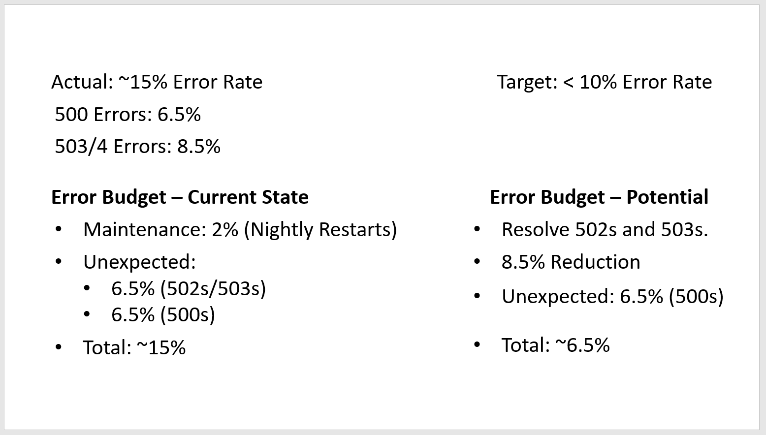

“Six months ago, we were seeing an error rate on HTTP requests of up to 15% per month which was well above our expected error budget of 10%. About 5% of these were caused by application errors, but 8.5% of these errors were being seen at the load balancer and were due to availability issues. We wanted our error budget to be 10% or less request errors, but we were tracking 5% above that. We had to improve something if we wanted to meet that target.”
“I got onto the NOC and spoke with Charlie who enlightened me to some issues we were having with our load balancer: it hadn’t been updated for a few years and a bug was causing all these errors. Further exacerbating the issue, no one with the skills to actually upgrade the load balancer worked at the company so that wasn’t an immediate option.”
“Jenny got onto the vendor and arranged training for the entire NOC. Within three weeks they were all skilled up, then we began our project to upgrade the load balancers. With everyone skilled up, it only took us two weeks to upgrade all of the servers and we were able to do this during downtime that was previously reserved for maintenance (otherwise known as restarting servers due to the bug). We’ve also begun transitioning all of the existing NOC operators to new SRE-based roles that will allow them to assume greater responsibility for the improvement of our core infrastructure.”
“Within two months of defining our current state error budget, we had used them to identify where our issues were coming from, resolved those issues, and, now we’ve been able to meet (and exceed) our target of less than 10% HTTP request errors. We’ve also used the experience to refine our NOC and give our staff greater responsibility.”
