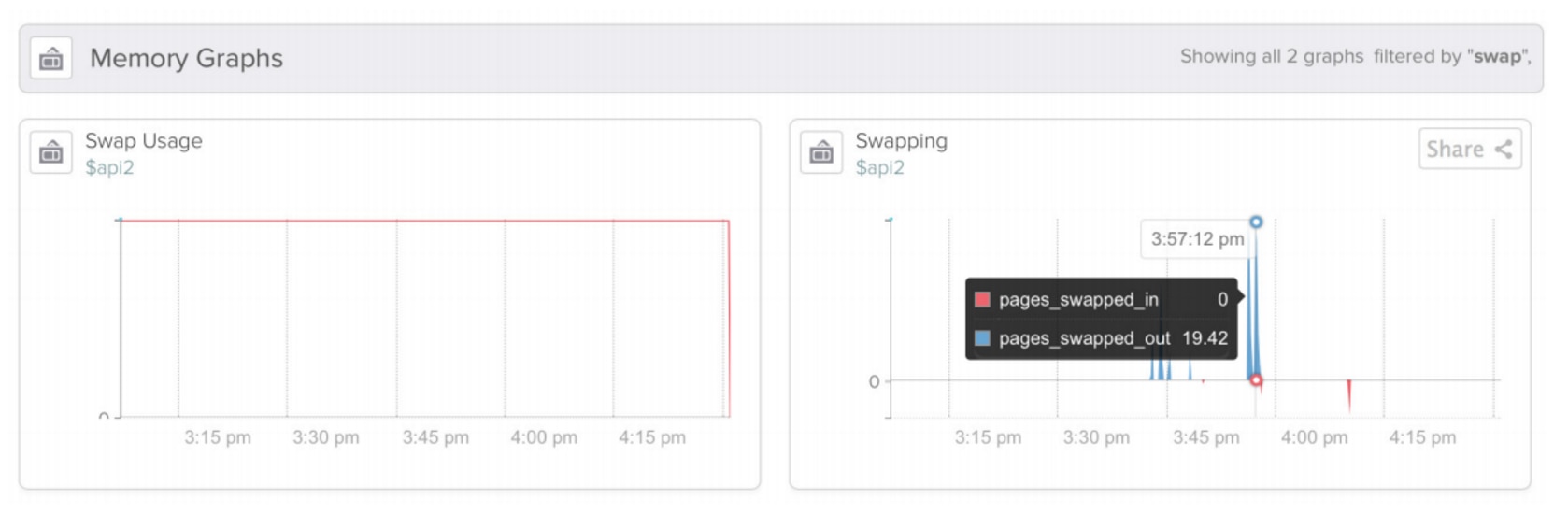

The first thing to know is that some settings can harm your server’s performance! There’s such a thing as too much of a good thing for specific memory buffers, for example. The most common consequence of setting a buffer too large is using swap, which slows the server down a lot. If your server is actively swapping everything will grind to a halt. For instance, you’re able to see swapping activity in SolarWinds® Database Performance Monitor’s memory graphs. Note that it’s okay if some swap is used; what you want to avoid is active paging in and out. Notice the difference between the graph on the left and the graph on the right in this screenshot.
swap

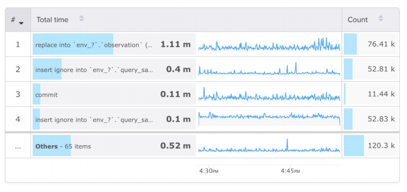

Even better than looking at status variables, though, is actual query performance. DPM measures and records every query’s execution, making it trivially easy to see what’s changed around a point in time. You can use the Compare Queries feature to see a before-and-after view of what’s changed, or just eyeball specific queries of interest in the Top Queries view. We’ve found many changes in query behavior in this fashion.
top queries

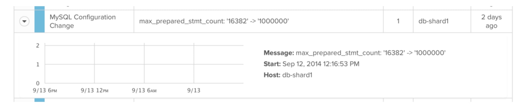

Keeping track of your changes is a good idea, too. DPM will help with this: each variable change is registered as an event, with the before-and-after value in the message. You can see this in your Event dashboard.
event dashboard
