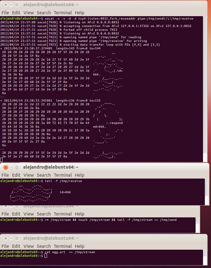

Setup
- Create a pipe to receive the payloads.
mkfifo /tmp/receive - Create a pipe to send the response payloads.
mkfifo /tmp/send - Create a file to stream the responses to the sending pipe (more on this later).
touch /tmp/stream - Set a console to read (and keep reading) from /tmp/receive.
tail -f /tmp/receive - Set a console to write (and keep writing) to /tmp/send.
tail -f /tmp/stream >> /tmp/send - Set socat to listen and accept connections on some port and:
- whatever it receives from the socket, it forwards it to the receiving pipe.
- whatever it receives from the sending pipe, it forwards it to the socket.
- print the payload in text and in hexa
Like this: socat -x -v -d -d tcp4-listen:8032,fork,reuseaddr pipe:/tmp/send!!/tmp/receive
And thats it!
Now we can make our ATM connect to port 8032 at localhost as if it were a true Bacon&Eggs system. Now, whenever our ATM software sends a bacon request with id=667, we just open our egg payload response example in a text or hex editor, replace 666 with 667 to make it a correct response and send it back.
cat eggs.payload >> /tmp/stream
BOOM!
Our ATM software receives a correct egg response for its bacon request and thus the transaction is approved. The connection is still open, so we can keep sending requests and responses and try different scenarios and use cases.
It’s like chatting with your software over a socket. Here is a screenshot of my human operated Bacon&Eggs protocol server processing a transaction.
