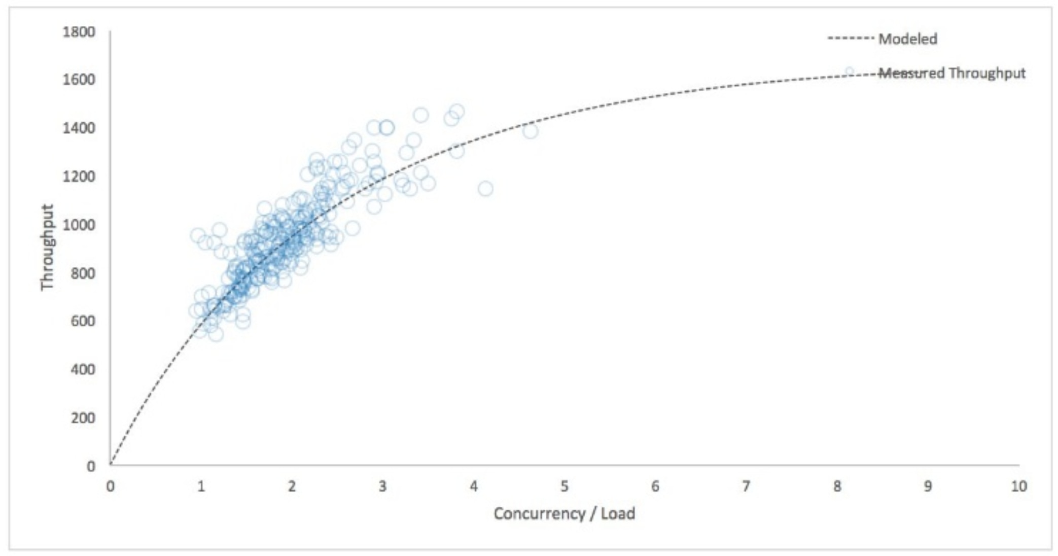

One of the appealing things about the USL is that it’s a black box model that doesn’t require too many detailed measurements of metrics that are difficult to get from real production systems. Instead, the necessary data is easy to get. The chart below, from a real customer system, shows the result of running such data through the USL model. In this case, it’s easy to see that this particular system will not scale linearly—we see a roll-off. The dashed line that’s curving over toward the right and the scatter plot of points demonstrates this clearly.
As this system gets more heavily loaded—measured by concurrency on the horizontal axis—we don’t see a linear line heading straight up off the chart. If you look closely at the curve of the line, it’s indicating that we can’t exceed more than 1,200 or so queries per second on this server. This server is operating in the region of non-linearity already, and we shouldn’t expect to be able to absorb twice the traffic. If we do, the system will produce long wait times, involving instances of the system timing out and even failing.

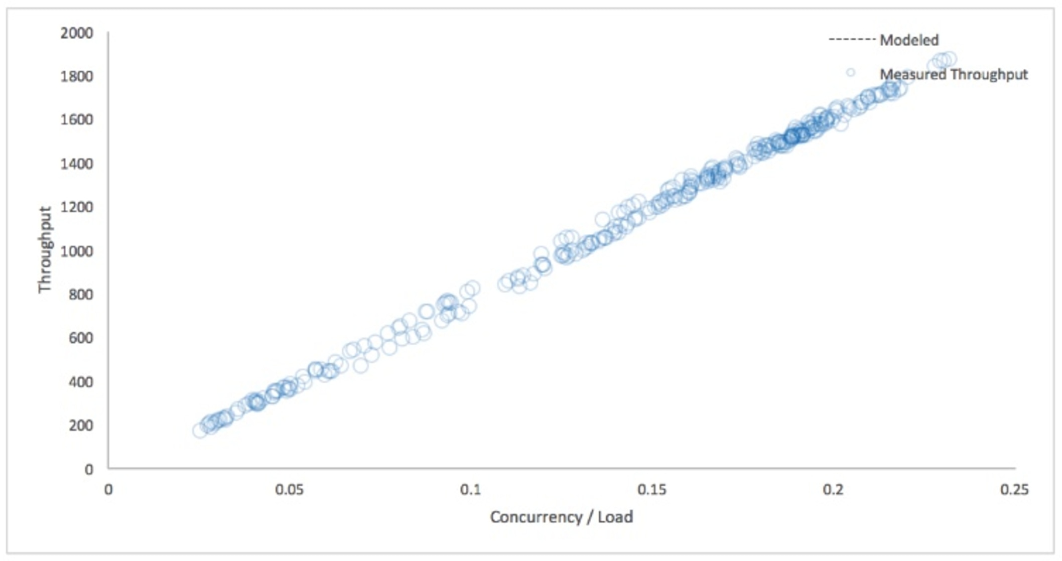

Let’s look at another example using the USL model. A customer approached us to look at some of their key systems that were only lightly loaded, but they nonetheless were open to analysis, to guarantee they weren’t missing anything. After pulling the data and plugging it into the USL, we saw the chart below. You can see by looking at the horizontal axis that the concurrency is very low.
Impressively, this server is barely strained—it’s only at a fraction of utilization. It’s also showing very linear scaling, and because they’re not entering any nonlinear regions, they can be confident that their systems can handle these loads effectively. That linearity is what you want to see!

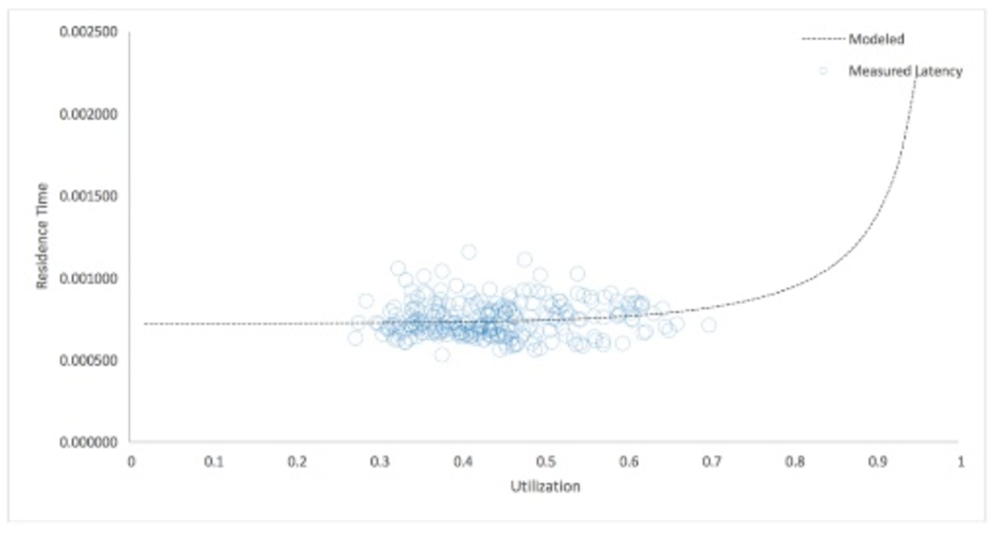

For example, as CPU and disks increase in utilization, you’ll see response times go through the roof. And these changes can happen abruptly. The graph below applies the equations from queueing theory to show IO utilization versus query response data from one of our customers. Note the elbow and then suddenly… boom. The model spikes into an almost vertical line. It gets much worse very fast.
With this analysis, we’re measuring response and utilization at different tiers: IO latency at the operating system and query latency at the database level using TCP sniffing with our SolarWinds® Database Performance Monitor software. The active results looked pretty good—the IO utilization increases were linear, but if we believe the model (as depicted in the graph) it actually says we might be getting into dangerous territory. What you could do in this situation is take traffic that is balanced across several servers and load it on this server and see if you can spike the IO utilization and see what happens to query latency.
