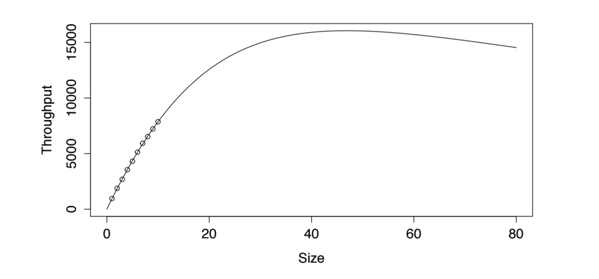

Here’s an example. Imagine that I had measured the first 10 data points in this benchmark (run on a Cisco server by Vadim Tckachenko), in a live production environment serving real users, not a lab. Here’s the result of fitting the USL to the data:
graph1

the USL predicts a max of 16,049 queries per second at a concurrency of 46 threads.
I have a rule of thumb for using the USL to project out into the unknown. I’ve seen so many systems that appear to be scaling beautifully—fitting the USL cleanly, just as this one does—and then they hit rough waters, that I don’t trust anything farther out than twice the measured throughput or twice the measured size, whichever comes first.1 And that’s if I’m not seeing telltale signs of leveling off or retrograde throughput. If I see those signs, I lower my expectations accordingly. I will also include other information such as CPU utilization to guide my estimates, if I have it, but in the absence of more data this is a good way to keep expectations capped.
Back to the model: I have measurements only to N = 10, where observed throughput is 7,867, so I’m going to compute the predicted throughput at N = 20. The result is a throughput forecast of 12,572. This is less than twice my maximum observed throughput, so I’ll allow it. In my experience, it’s an optimistic but not unrealistic guess that I won’t get more than about 12,500 queries per second from this server. (As you may remember, this system topped out at 12,211 QPS.)

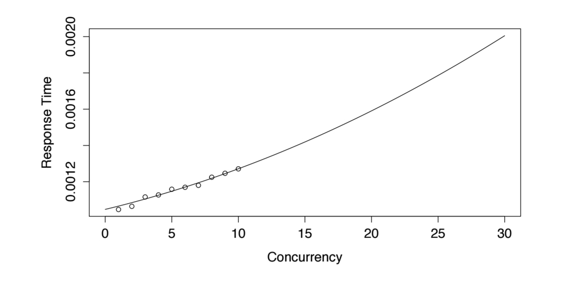

As a first step towards this, I can use average latency to help understand the potential QoS end-users will get from this server. Again using the rearranged form of the USL, I obtain the following response time forecast:
graph2
Using the estimated coefficients and the formula for response time from Equation 6, I can predict a mean response time of 0.00159 seconds at 20 threads. Let’s imagine that this is unacceptable; I need mean response times to be 1.5ms or less. Solving the response time equation as a function of latency lets me use it to compute the maximum usable concurrency. The resulting equation has two roots; I’m only interested in the positive one:
equation2
Plugging in an R target of 0.0015 yields N = 17, so if I want to avoid violating my SLO I can’t drive my server higher than approximately 11,450 QPS. I’m actually at about two-thirds of my usable capacity, not half. I can grow traffic about 145% before I get into trouble, if I’m lucky.
