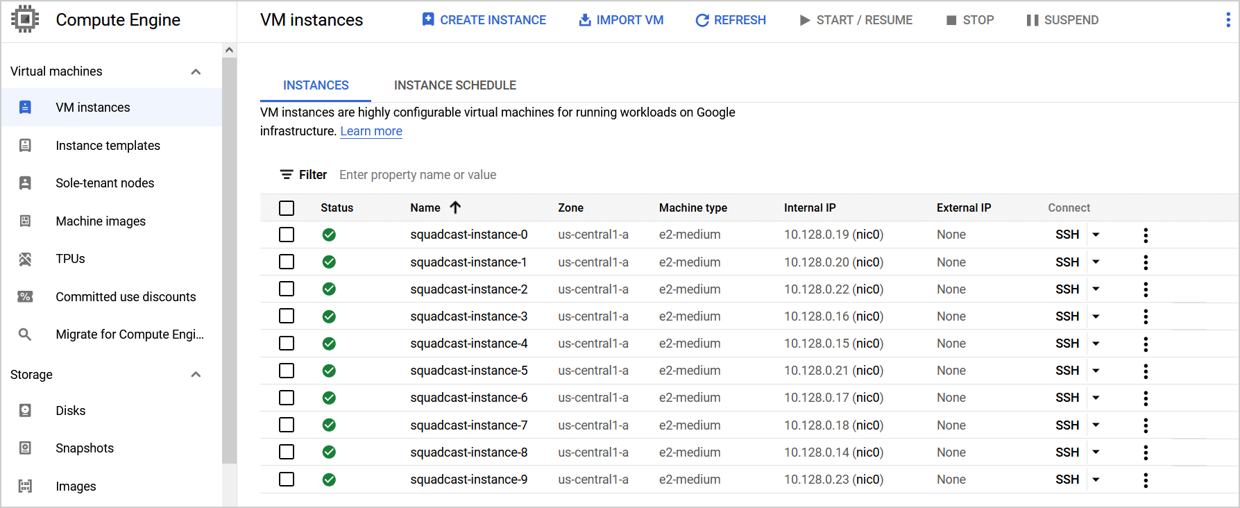

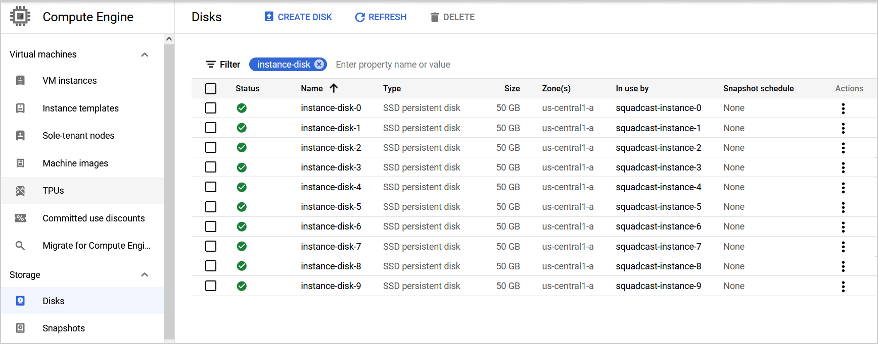

You can now see how IaC can help automate creating multiple instances.
To demonstrate the power of IaC, let’s take on the task of creating the ten instances here.
Three commands are executed in succession:
  • terraform init – to initialize Terraform, prepare, and download all the necessary files before running
  • terraform plan – to print out the execution plan on what infrastructure elements will be created(or deleted)
  • terraform apply – finally applying the staged changes and executing the creation of the instances
In a breeze, all the instances are created along with the extra pair of disks.
