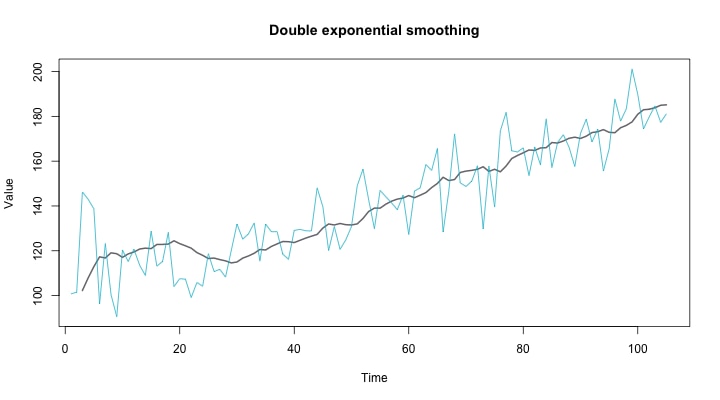

Notice how the smoothed values are much better at following the original time series with double exponential smoothing. This means you’ll get much better forecasts.

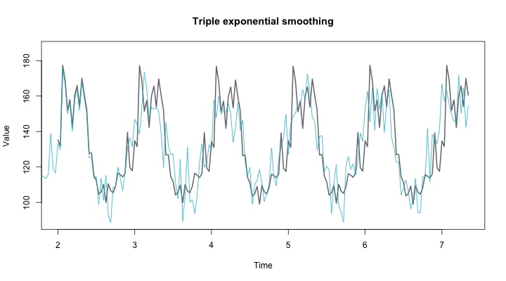

The three aspects of the time series behavior—value, trend, and seasonality—are expressed as three types of exponential smoothing, so Holt-Winters is called triple exponential smoothing. The model predicts a current or future value by computing the combined effects of these three influences. The model requires several parameters: one for each smoothing (ɑ, β, γ), the length of a season, and the number of periods in a season.

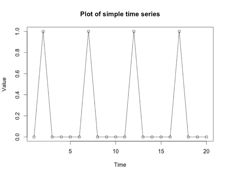

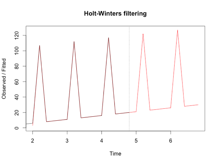

The usual way to explain Holt-Winters is by showing a bunch of complicated equations with Greek letters and subscripts. We’ll skip the math and show how it works, which is a lot simpler. We’re going to be working with this time series:

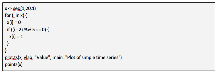

Here’s the R code I used to generate that.

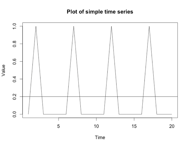

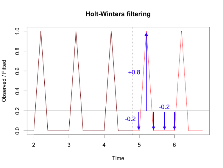

The pattern is obvious: the plot repeats the values [0, 1, 0, 0, 0]. Can you tell me what the next five values are going to be? Of course you can, because I just told you! They are [0, 1, 0, 0, 0]. What would it look like if we made the values relative to the average of those five points? The average of (0+1+0+0+0)/5 is 0.2, which we’ll draw on the plot as a horizontal line:
Holt-Winters has a trend component. If we set its parameter to zero, Holt-Winters ignores the trend (slope), so the model simplifies. Now, it’s just a bunch of values relative to the average. In our plot, the values relative to 0.2 are [-0.2, 0.8, -0.2, -0.2, -0.2]. If we did Holt-Winters without trend, that’s the type of model we’d build. Here’s what the Holt-Winters function in R gives, with some annotations in blue I added manually:
Forecasting with trend is just an enhancement of this. Instead of using a fixed average as the foundation, you have to incorporate the slope of the line. Here’s a model with a trend:

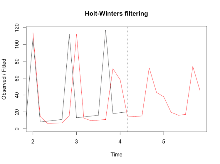

You already know, by definition, the example series repeats itself every five points, i.e., the season is five periods. What if you didn’t know what the season is for a time series? How can you figure it out? What are the consequences of being wrong? The right seasonality is crucial to Holt-Winters forecasting. To illustrate this, let’s see what happens when you use a season of six periods, one greater than the actual season of five periods:
The forecast, which is the red line in the chart, becomes less accurate and turns into garbage. To get good results, you need to give the model good parameters. This is the second challenge with Holt-Winters forecasting.

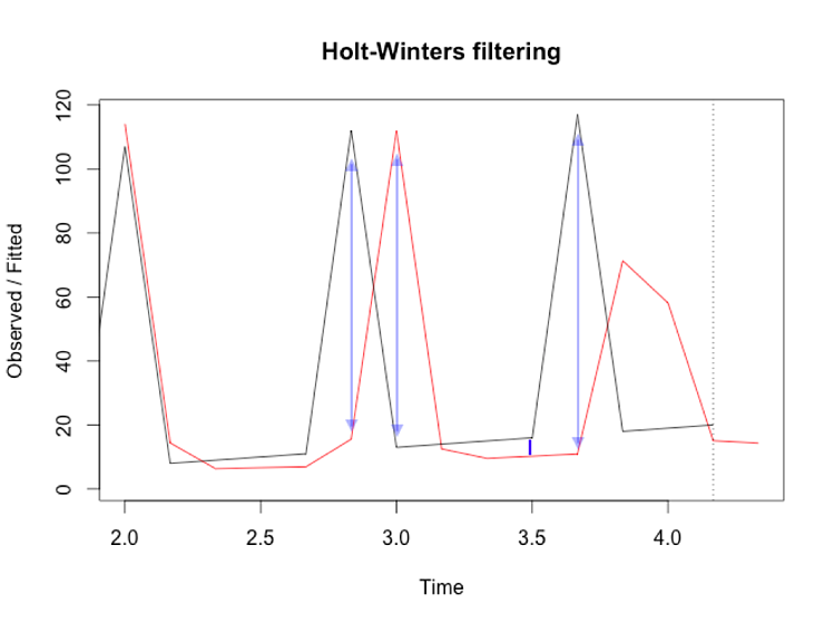

Let’s quantify how good a forecast is. The last forecast was bad, but how bad? The usual way to quantify the accuracy of a forecast is to calculate the differences between the predicted values and the actual values. The blue arrows in the following chart represent how far off the prediction was from the actual value.
To quantify overall accuracy, you can combine these differences into a single value by taking the average or the sum of squared values. The result is a value that’s smaller if the forecast is better, and larger if the forecast is worse. This gives you a good way to compare forecast results.

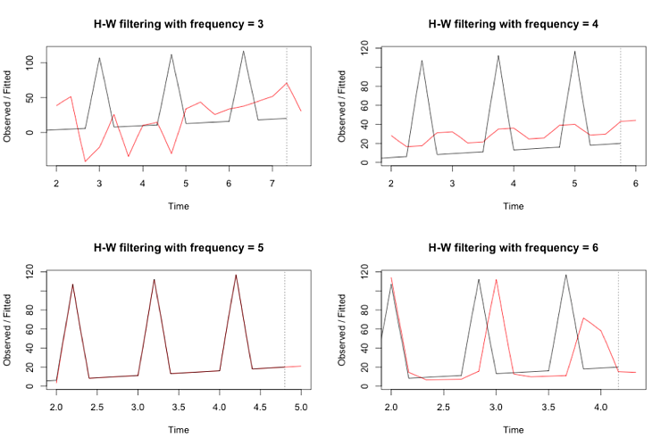

Our forecasting code tries lots of combinations (lots!) with different parameters and picks the ones that generate the lowest combined error score. To illustrate this, here are a bunch of forecasts on the same time series, trying out different frequencies.
The one with the right seasonality (five periods per season) is easy to pick out visually because the differences between the data and the forecast are small. This is a visual example of what our forecasting does through optimization. It also optimizes other parameters, such as the trend.
