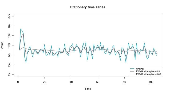

Exponential smoothing refers to the use of an exponentially weighted moving average (EWMA) to “smooth” a time series. Here’s a plot of a stationary time series along with a couple of smoothed versions. Notice how the smaller the weight, the less influence each point has on the smoothed time series.

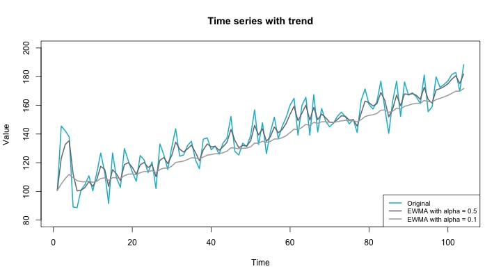

Trend refers to a long-term movement of a time series in a particular direction. With linear trend, time series points will approximately follow a line. It’s also possible to have higher order trends, such as quadratic trend where points follow a parabola.

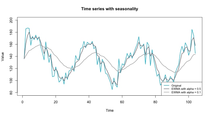

Seasonality refers to a periodic pattern. A great example of a seasonal time series is the temperature in a particular location. A time series can have multiple seasons with different periods.

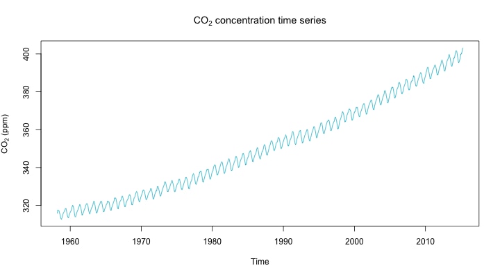

The Keeling Curve, which plots the measured concentration of CO2 in the atmosphere, has a positive trend and seasonality.
You may notice something interesting going on with the smoothed series with the lower weight. It tends to lag behind our original data because more recent values have lower influence. This is especially noticeable with the seasonal time series. This is important! Because you’re using the smoothed values to forecast, any significant deviation in the smoothed values will throw off your prediction. If you notice your time series isn’t stationary, you’ll have to find something other than a simple EWMA to do your forecasting.

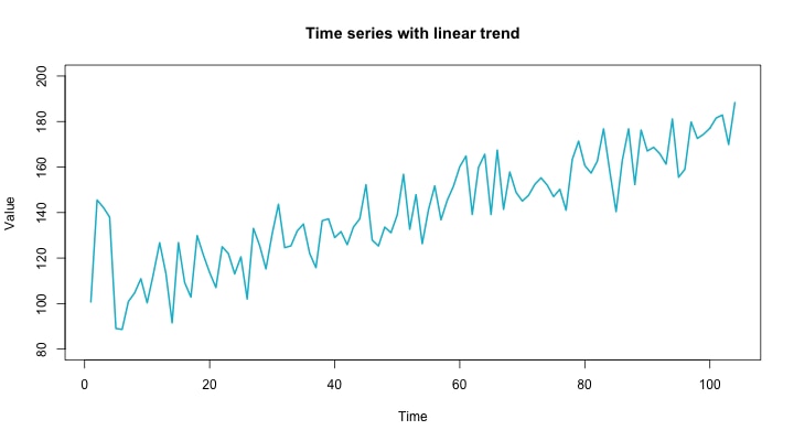

In the late 1950s, Charles Holt recognized the issue with the simple EWMA model with time series with trend. He modified the simple exponential smoothing model to account for a linear trend. This is known as Holt’s exponential smoothing. This model is a little more complicated. It consists of two EWMAs: one for the smoothed values, and another for its slope. The terms level and trend are also used.
The smoothed values are much better at following the original time series with double exponential smoothing. This means you’ll get much better forecasts.

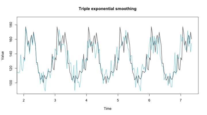

However, what if your time series doesn’t have a linear trend, but rather some sort of seasonality? For this, you’ll need yet another EWMA.
Holt’s student, Peter Winters, extended his teacher’s model by introducing an additional term to factor in seasonality. This model, with level, trend, and seasonal components, is known as Holt-Winters. It is also referred to as triple exponential smoothing. Now there’s another variable, which depends on the period of the seasonality and has to be known in advance.
