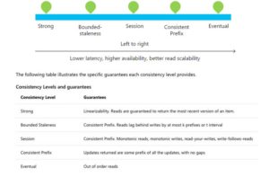

Consistency means that any read request will return the most recent write. But as we have discussed earlier, consistency need not be immediate. Our requirements could be satisfied with a state of eventual consistency. This graph helps explain the different consistency levels.
From: https://docs.microsoft.com/en-us/azure/cosmos-db/consistency-levels

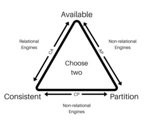

Here’s what the CAP theorem looks like:
Let’s look at each side the triangle above (labeled CA, AP, and CP). Traditional relational databases are a natural fit for the CA side. That is, they can feature strong consistency and be highly available, but often at the expense of partition tolerance.
Non-relational database engines are meant to satisfy AP and CP requirements. This is why we have so many flavors of NoSQL: key-value, document, and graph, to name a few. We have two sides of the triangle supported by NoSQL database engines. That means we have a large variety of availability and partitioning requirements along with specific query and workload requirements. It is easy to understand why we have so many NoSQL solutions available.
