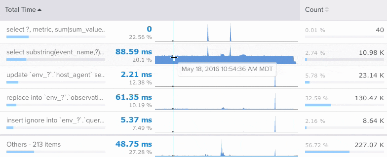

When you move the mouse over the metrics charts, Database Performance Monitor shows the values at the relevant, viewed point. We do this not only in the chart you are hovering over, but in all charts on the screen at the same time, so you can see all values at the time of interest, in any of the displayed metrics.
The animation below shows what this looks like when the system is struggling to keep up and there’s a delay — notice the lag. (The gif at the bottom of this article shows how it looks at full speed!)

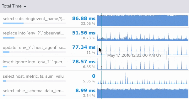

The Profiler tool shows a lot of information on the screen. You can rank up to 50 queries and toggle ON for more than 20 columns, each of which contains one bar chart and two numbers.
If you look closely at the table, you can easily count up to 5 individual pieces of information on each cell. If we had, say, an average of two Angular bindings per component, then the number of $watchers per row could easily reach half a hundred. And that, multiplied by the number of rows, means … a whole lot of them.

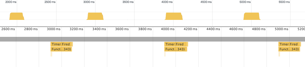

The code appears harmless. But looking at the Timeline tab in Dev Tools, you’ll see something like this:

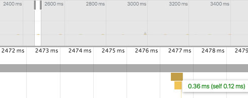

Pretty obvious… but if you zoom in and look closer, each one of those peaks becomes something more like this:
Now, that looks pretty bad. Again, Angular needs to execute the whole $rootScope.$digest each time the timer fires up to see if anything needs to be updated in the UI. If, like us, you have no need for this timer to execute inside Angular, then you can use the old window.setTimeout and window.setInterval and save some trees. The result is the timer instead takes about 30 ms to execute.

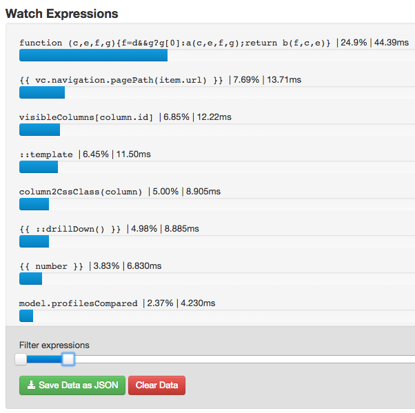

The Performance tab comes in handy here, because it displays all the running $watchers and sorts them by accumulated running time. Using this, you can find out which are the watchers executing in your page, and which of them are the most expensive.
Additionally, it allows you to slice the ones you want to see with a convenient slider at the bottom. So you can, for instance, focus your efforts on the top 20% of them.
By using this tool, we were able to quickly identify and remove unneeded $watchers; cache results for the expressions that don’t change; replace expensive expressions with more cheaper ones; plus all sorts of other improvements.
Our results were immediate gains in performance — the CPU usage reported by the Chrome Task Manager went down from 60% to 0.5% in some cases.

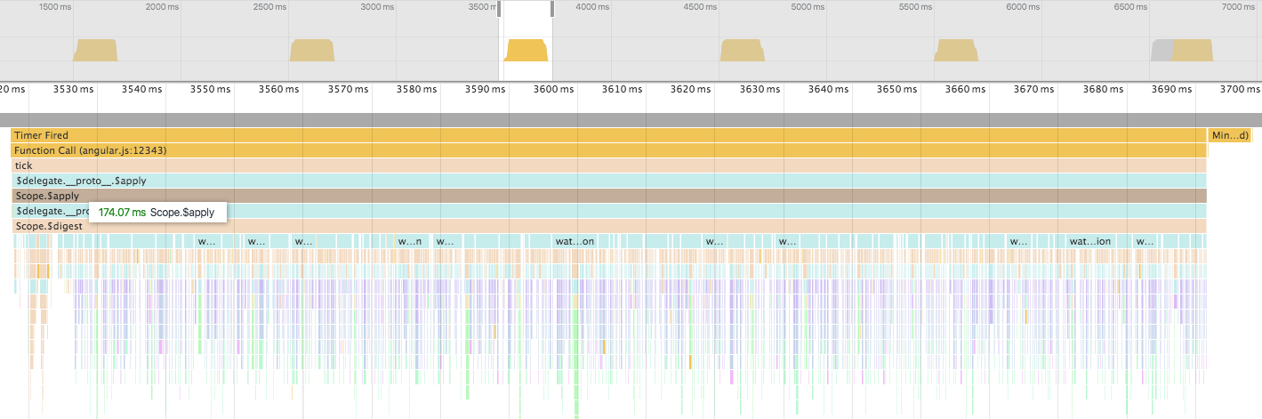

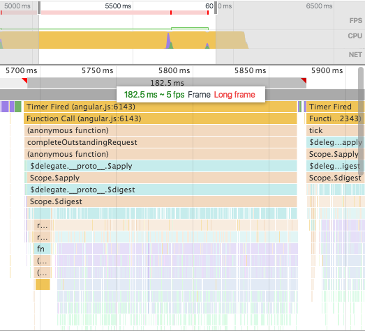

But this isn’t enough. After doing all this, chances are you’ll still have $watchers in your code that you can’t possibly remove without altering the functionality of your page. To go deeper and optimize those, we need to know what specific code Angular is executing on each $digest, and how much time it takes. The Timeline tool can help out here.
If you don’t know what the Timeline is, then please do yourself a huge favor and go give it a try now: open your Angular app in Chrome, open Dev tools, go to the Timeline tab, and hit the record button. Interact with your app a bit… and boom. If you’re unlucky, you’ll see something like this:
There are all sort of performance problems shown right there. For example, note the red triangle in the upper-right corner of the rectangle surrounding the timestamp “182.5 ms.” This triangle indicates the browser has failed to keep up with rendering the page at the desired frame rate, because your JavaScript code was executing. So if you see a lot of these warnings, then there’s a good chance you can improve the perceived performance of your app.
While interacting with your app, sometimes you trigger reflows or repaints. This means the browser has to render portions of the screen. It’s desirable to do this at a frame rate between 30 and 60 per second. If you cross the 60fps barrier, you’ll notice lag or flickering.
The Timeline tab shows the individual frames rendered and the time they took, so you can see exactly what’s slow and where you should look to optimize.
