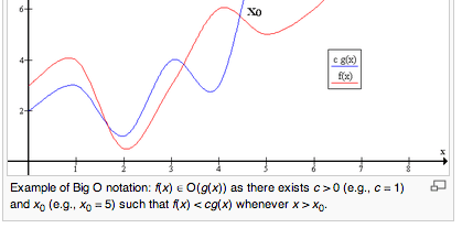

Asymptotic Complexity and Upper Bounds
There are a few subtleties to keep in mind. All of these are really just generalizations that allow you to casually speak about algorithms without being very specific, with a wave of the hand, and yet get to the essence of their performance.
  • Big-O notation really means that the problem can be “as bad as” the equation inside the parentheses. It’s an upper bound — a worst-case scenario.
  • Big-O notation is expressed as the limiting factor as the size of the problem grows “very large.” Thus, even if at a small size the algorithm’s cost is dominated by a huge initial cost, what we’re interested in is what happens as the size goes to infinity.
  • If there are multiple types of algorithmic costs, we disregard all but the worst as size goes to infinity, because eventually it will dwarf all other factors.
