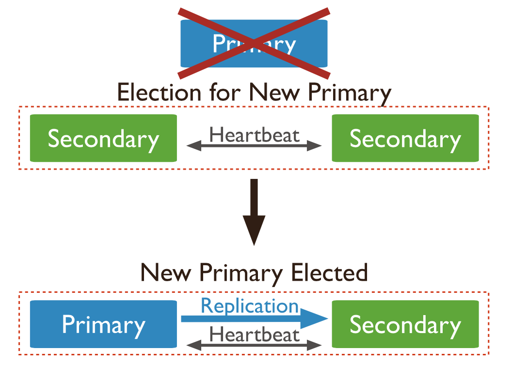

While MongoDB offers standard “primary-secondary” replication, it’s much more common to use MongoDB’s “replica sets.” Replica sets involve multiple coordinated MongoDB instances, which work together to ensure superior availability. These are structured so that one instance is designated as the primary instance while the rest act as replica nodes. If the primary ever fails or becomes unavailable, one of the replicas will automatically be “elected” as the replacement. The election process is sophisticated and is a built-in element of MongoDB—you can read more about the “Factors and Conditions that Affect Elections” here.
Screenshot from MongoDB Manual 3.4 Documentation
