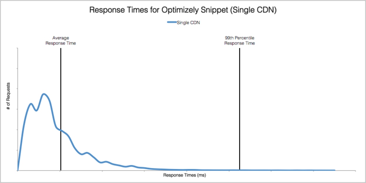

Optimizely did a write-up in this blog post from a couple years ago. It illustrates beautifully why averages can backfire:
“While the average might be easy to understand it’s also extremely misleading. Why? Because looking at your average response time is like measuring the average temperature of a hospital. What you really care about is a patient’s temperature, and in particular, the patients who need the most help.”
Brendan Gregg also puts it well:
“As a statistic, averages (including the arithmetic mean) have many practical uses. Properly understanding a distribution isn’t one of them.”

Source: Catchpoint.com, data from Oct. 15, 2013 to Nov. 25, 2013 for 30KB Optimizely snippet.

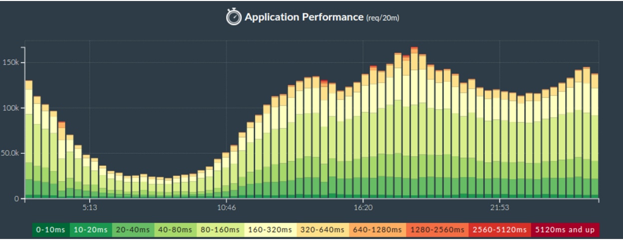

A better way to compute percentiles with a time series database is to collect banded metrics. I mention the assumption because lots of time series databases are just ordered, timestamped collections of named values, without the capability of storing histograms.
Banded metrics provide a way to get the same effect as a series of histograms over time. What you’d do is select limits that divide the space of values up into ranges or bands, and then compute and store metrics about each band over time. The metric will be just as it is in histograms: the count of observations that fall into the range.
Choosing the ranges well is a hard problem, generally. Common solutions include logarithmic ranges and ranges providing a given number of significant digits but may be faster to calculate at the cost of not growing uniformly. Even divisions are rarely a good choice. For more on these topics, please read Brendan Gregg’s excellent write-up.
The fundamental tension is between the amount of data retained and the fineness of the resolution. However, even coarse banding can be effective for showing more than simple averages. For example, Phusion Passenger Union Station shows banded metrics of request latencies using 11 bands. (I don’t think the visualization is the most effective; the y-axis’s meaning is confusing and it’s essentially a 3d chart mapped into 2d in a nonlinear way. Nevertheless, it still shows more detail than an average would reveal.)
How would you do this with popular open source time series tools? You’d have to define ranges and create stacked charts as shown.
To compute a percentile from this would be much more difficult. You’d have to range over the bands in reverse order, from biggest to smallest, summing up as you go. When you reach a sum no more than 1% of the total, that band contains the 99th percentile. There are lots of nuances in this—strict inequalities, how to handle edge cases, what value to use for the percentile (upper or lower bin limit? in the middle? weighted?).
And the math can be confusing. You might think, for example, you need at least 100 bands to compute the 99th percentile, but it depends. If you have two bands and the uppermost band’s value contains 1% of the values, you’ve got your 99th percentile. (If that sounds counterintuitive, take a moment to ponder quantiles; I think a deep understanding of quantiles is worthwhile.)

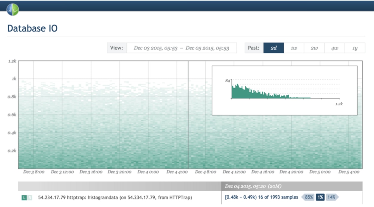

Enter heatmaps, which are essentially 3-D charts where histograms are turned sideways and stacked together, collected over time, and visualized with the darkness of a color. Again, Circonus provides an excellent example of heatmap visualizations.
On the other hand, as far as I know, Graphite doesn’tt have the ability to produce heatmaps with banded metrics. If I’m wrong and it can be done with a clever trick, please let me know.
Heatmaps are great for visualizing the shape and density of latencies, in particular. Another example of heatmap latency is Fastly’s streaming dashboard.

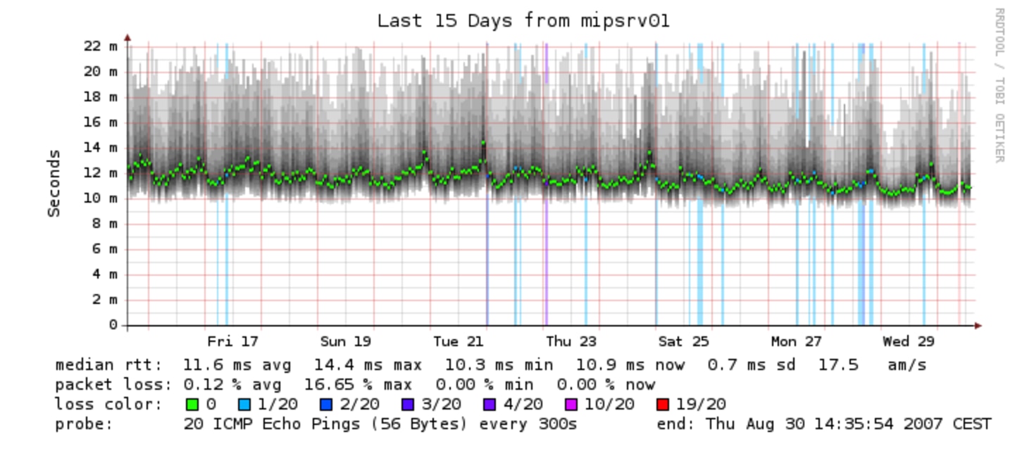

Even some old-fashioned tools you might think of as primitive can produce heatmaps. Smokeping, for example, uses shading to show the range of values. The bright green is the average:
