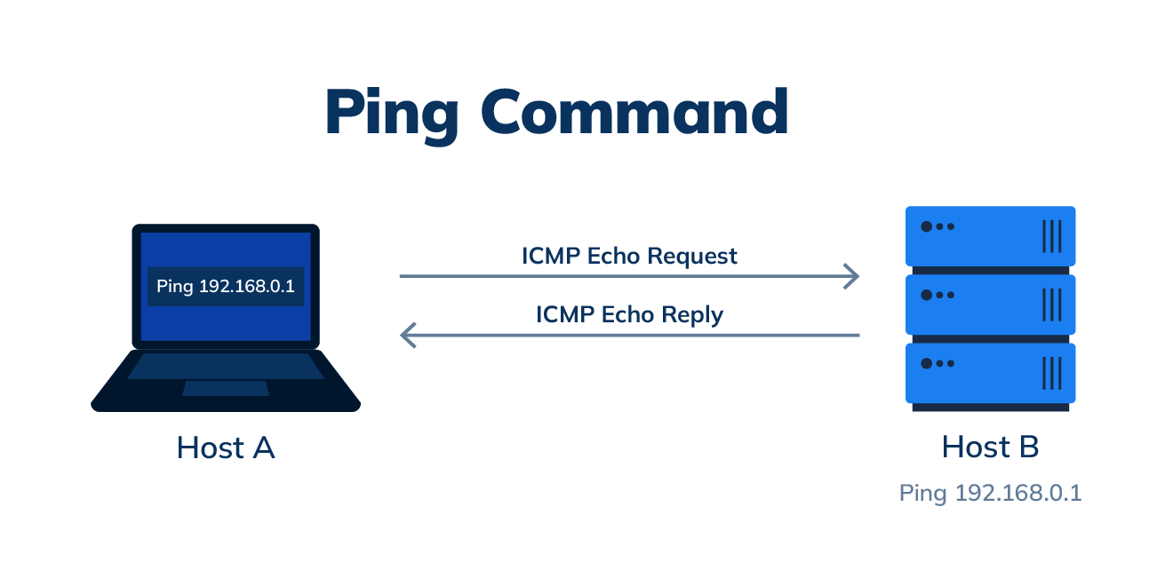

What is Ping Command and how does it work with Internet Control Message Protocol?
The Ping command is a network utility tool that is widely used to test the reachability of a host (usually a computer or a server) on an Internet Protocol (IP) network. It also measures the round-trip time it takes for a data packet to travel from the source device to the destination and back. The term “Ping“ is derived from sonar technology, where a pulse of sound is sent, and the time it takes for the sound wave to return provides information about the location of objects. The term is also an acronym for Packet InterNet Groper, highlighting its function as a network troubleshooting utility.
Here’s a brief overview of how the Ping command works:
  1. Initiation: When you execute a Ping command, your computer generates a small packet of data, often an Internet Control Message Protocol (ICMP) Echo Request packet.
  2. Transmission: This packet is then sent to the target IP address or domain. If the destination is reachable and responsive, it acknowledges the receipt of the packet by sending back an ICMP Echo Reply.
  3. Round-Trip Time (RTT): The time it takes for the packet to travel from the source to the destination and back is measured and reported by the Ping command. This duration is known as the Round-Trip Time (RTT) and is often expressed in milliseconds.
  4. Statistics: Ping also provides additional statistics, such as the packet loss rate, which indicates the percentage of packets that did not successfully reach the destination.
The default behavior of ping commands involves sending multiple requests, typically four or five, and presenting the outcomes. The echoed ping results indicate if a specific request obtained a successful response. Additionally, it provides details such as the received byte count and the duration taken to receive a reply, known as the time-to-live.
