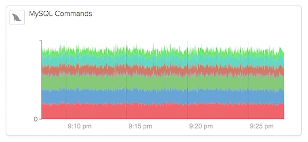

At this point we know more about COM_PING, but we don’t yet know the impact. The first thing you might notice with DPM is the size of the Com_admin_commands stripe in your Commands graph. Here it’s the red stripe on the bottom (in the app you can see that if you mouse over it, but I’m not showing that here because it takes up too much vertical space).

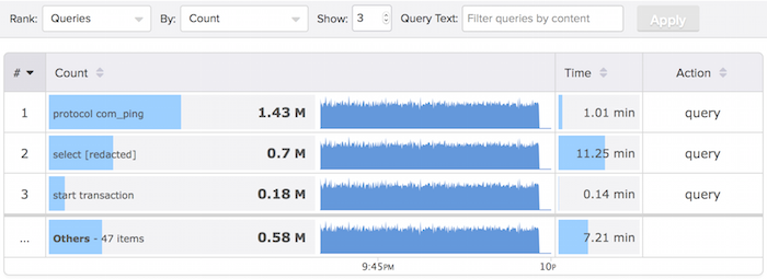

Now, if we didn’t know what was inside that counter, we’d have to stop there. But in DPM, every command to the server is represented as a query. If we go to Top Queries, and rank by Count, we’ll see the following:
Measuring_Pings_With_VividCortex
Notice that the number 1 query by count, more than twice as big as the second one, is protocol com_ping. That’s the pseudo-query we use to identify this protocol command. It is about half of the total queries this server runs (which makes total sense, because with an ORM like the ones above, every time you run a query, you run this command first). And look, during the 20-minute period shown in the screenshot, it accumulated more than a minute of total latency!

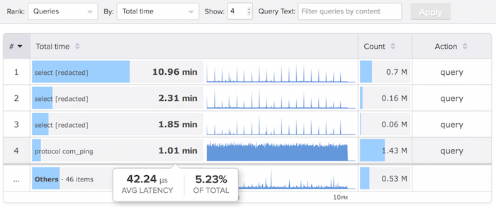

Naturally, we can switch to view queries by time instead of count. Do you think pings are far down the list? No, they rank #4 by total time, accounting for more than 5% of the total work this server does.
Measuring_Pings_With_VividCortex_2
The story from the app’s point of view is even worse, because that 5% of server-side latency is magnified by the network round trip and the processing the app has to do.
