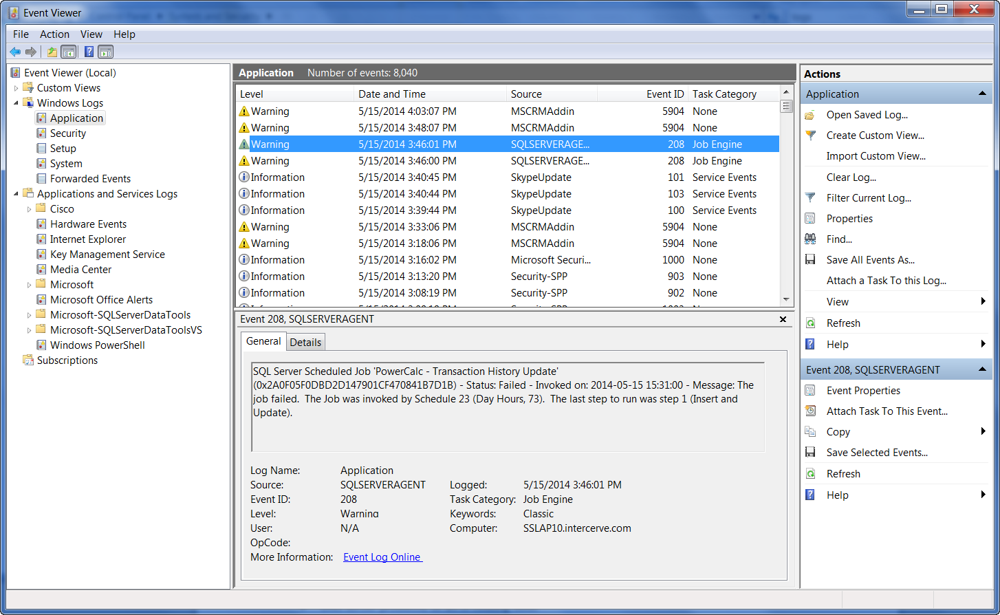

Unfortunately, to get anywhere close to what PA does, you have to jump through several hoops. In the world of experienced DBAs, the first step is to check the Windows Event Viewer ==> Application Log and ==> System Log to make sure that there are no significant error messages related to other, non-SQL Server components of the corporate infrastructure.
Sidebar: I learned to make this the first step in my troubleshooting methodology, after wasting time trying to fix what I thought was a SQL Server problem. Only later, and after many wasted hours, did I discover that there was a host of DNS errors, or Domain Controller errors, or IO subsystem error messages.
An example of the Windows Event Viewer is shown below in Figure 1:
Windows Event ViewerFigure 1: The Windows Event Viewer, Application Log
This brief step only takes a few moments to rule in or rule out behaviors coming from outside of the SQL Server itself, such as the network or the SAN. If a problem exists outside of SQL Server, you can quickly hand the problem off to the appropriate team. If there is no correlation to a problem outside of SQL Server, then you know to keep digging to the next level of investigation within the SQL Server stack.
If there is a non-SQL Server error in the Windows Error Logs, such as networking or storage array errors, you are now able to quickly hand off the problem to the appropriate team, if you work in a silo’d organization. And if not, you know now enough to work on the non-SQL Server error.
For an outstanding deep dive into the SQL Server error log, read Erin Stellato’s (b | t) post Proactive SQL Server Health Checks, Part 4 : ERRORLOG.
You may have noticed in the example shown earlier in Figure 1 that there was an actual SQL Server database error visible in the log. This points out the other benefit of checking the Windows error logs, namely, finding an error is often a good thing (yes, you heard it correctly) because the error message frequently points out where and how to remedy the problem. The alternative of finding no error is more research, sometimes a lot more, to properly diagnose and resolve the problem.
However, consider the warning message that appeared in Figure 1:
SQL Server Scheduled Job ‘PowerCalc – Transaction History Update’ (0x2A0F05F0DBD2D147901CF470841B7D1B) – Status: Failed – Invoked on: 2014-05-15 15:31:00 – Message: The job failed.  The Job was invoked by Schedule 23 (Day Hours, 73).  The last step to run was step 1 (Insert and Update).
In this case, the problem is that an important job, invoked by SQL Server Agent, failed prior to completion. A waits-only approach to troubleshooting is likely to miss any sort of error like this because the problem at hand, the failed job, did not contribute to runaway resource consumption. In fact, because the job failed and terminated processing, this resulted in fewer resources consumed. A waits-only based approach would perceive this to be a good thing™.
Waits-only performance monitoring can fail to detect erroneous behaviors, especially when the error causes an abnormal termination of a process that reduces wait times.
Because we checked the Windows Application Log and saw that there was a SQL Agent job failure, we now have an easy course of action. Fixing this problem is as simple as troubleshooting the job so that it can complete successfully.

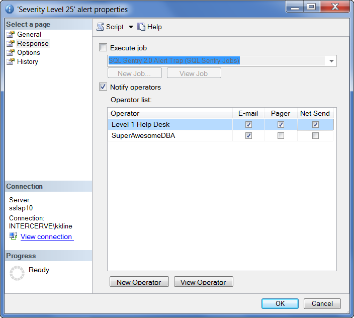

The basic alert is now configured. However, the most important part is how you respond to the alert, as found on the next page of the Alert Properties dialog. This is the Response section of the alert, as shown below in Figure 3:
Troubleshooting Wait Stats WP, Figure 06Figure 3: The Alert Properties Response Dialog Box
You can optionally choose a variety of ways to respond to an error of a given severity level, such as to invoke a specific SQL Agent job or to email, page, or Net Send a message to a given operator. At a minimum, make sure to create an operator who will receive emails and other forms of notifications when the significant error occurs.
