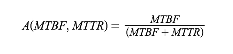

Availability is a combination of how often things are unavailable and how long they remain that way. These two factors are often abbreviated as MTBF (mean time between failures) and MTTR (mean time to recovery).
MTTR and MTBF are the independent variables in the availability function, A:
You can also derive some other functions from this one, including the probability of failure F, which is 1-A; and reliability (R) which is 1/F, or 1/(1-A).
But the availability function A is interesting to examine in more detail.

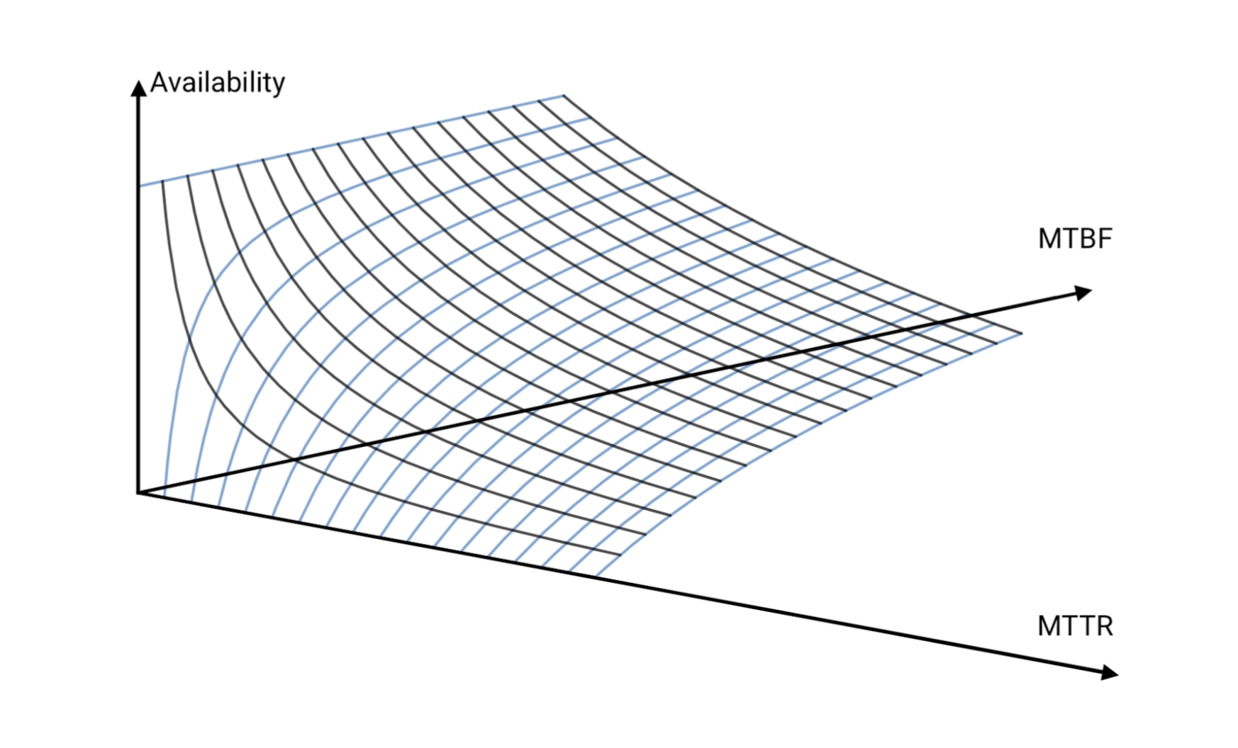

If you want to achieve high availability, what should you strive for—short outages, or rare outages? To answer this question, let’s first look at the shape of the availability function.
This is a graphical representation of the function, which shows  availability is best when MTTR is short and MTBF is long. If you’d like to see an interactive version of this plot, you can find one at Desmos.
It’s obvious from both the chart and the equation that the limit of availability is 1 as MTTR decreases to 0, and as MTBF increases to infinity.
