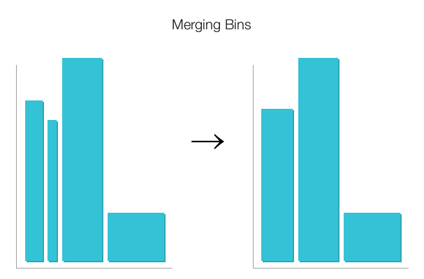

We’ve decided to implement histograms that are dynamic, compressed, and offer efficient quantile approximations. They’re dynamic in that they do not have fixed bin values, and bins adapt to the data that streams in. The histograms also have a fixed maximum bin count, so resource usage stays constant regardless of how many values stream in.
The algorithm is fairly simple. A histogram is created with a maximum bin count. Each new value streamed into the histogram creates an additional bin with a count of 1. If the current bin count is higher than the maximum, the closest bins are merged. Close refers to the distance between the values of the bins. The higher the maximum bin count, the better the approximations at the cost of greater resource utilization and computation time.
