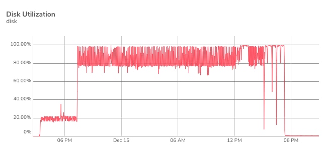

Even if your query doesn’t have to do a lot of work, its execution isn’t isolated from the rest of the work being done in a system. If your resources like disk I/O, network throughput, or CPU are at capacity, then your queries can take more time to run.

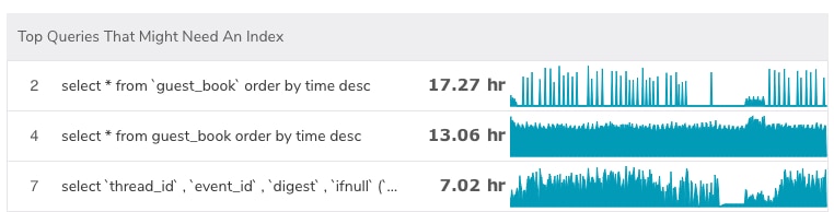

The query profiler in Database Performance Monitor (DPM) can show you top queries consuming a large portion of your database’s execution time without using indexes. In many cases, adding an index reduces the amount of data the server needs to examine to run the query and improves execution speed.

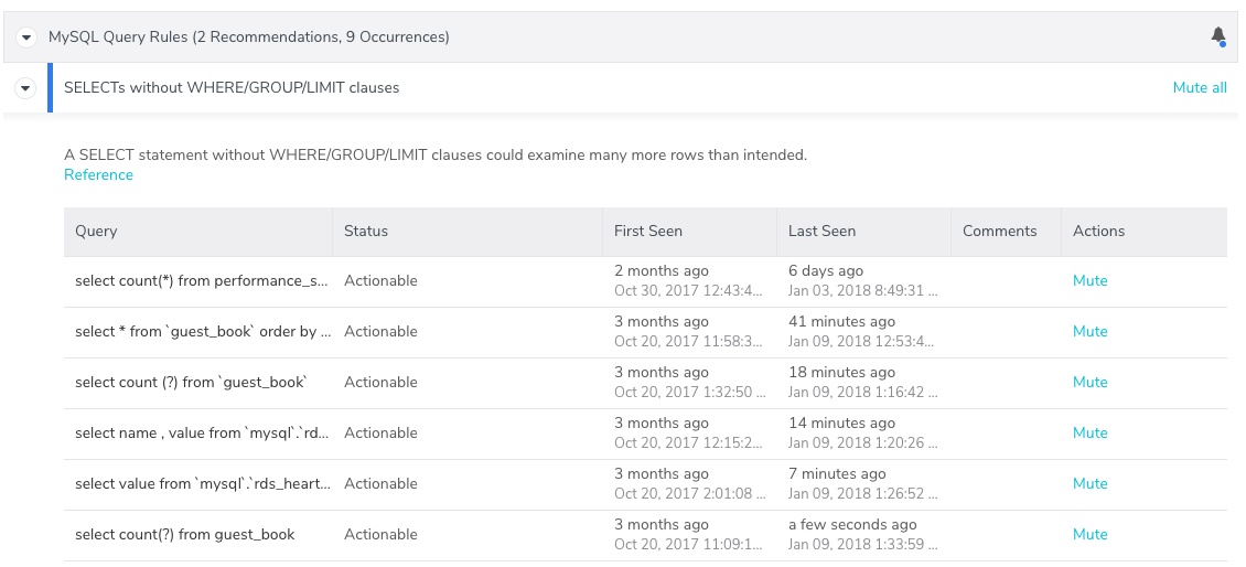

DPM also performs SQL analysis to let you know if a query could use improvement based on best practices.

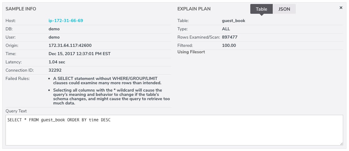

DPM also captures explain plans automatically, so you can immediately see the execution plan of a slow query, and see how it changes over time or across hosts.
