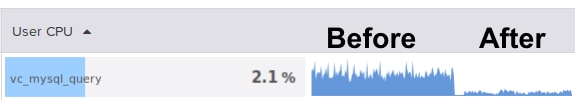

This reduces our already-low overhead and enables higher accuracy in certain circumstances. Here’s a before-and-after image:
Agent_Overhead

You already saw a chart of CPU at the top of this blog post, but I’ll repeat it for fun. We capture per-process CPU, I/O and more from your operating system, so we can see exactly how this change impacts agent resource usage. Here’s the agent’s CPU again:
Agent_Overhead

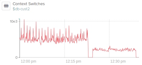

System CPU decreases about the same as user CPU, too. At the same time, we see changes in related metrics such as context switches:
Results
The context switches decrease because of the C-to-go calls that our agent makes to interface with libpcap.
