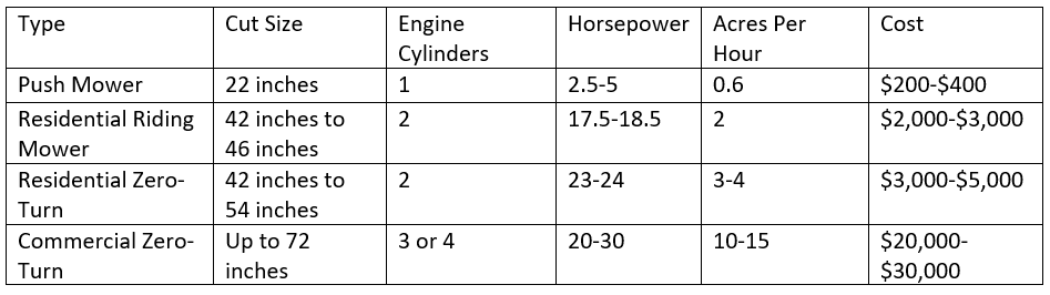

If I have an acre of grass needing to be mowed, there are multiple mowers out there having pros and cons associated with them. Consider the following table of different mower types, sizes, and costs with the amount of work expected from a typical adult using the machine.Lawn Mowing Table-1
A standard push mower is relatively cheap, and a typical person can mow an acre in under two hours. A standard 42-inch riding mower should be able to cut the same acre in under half an hour, and a zero-turn mower should be able to do it in 15-20 minutes. However, despite owning one of the top end residential zero-turn mowers, it takes my son an hour to cut an acre of grass. Why?
