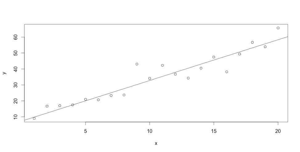

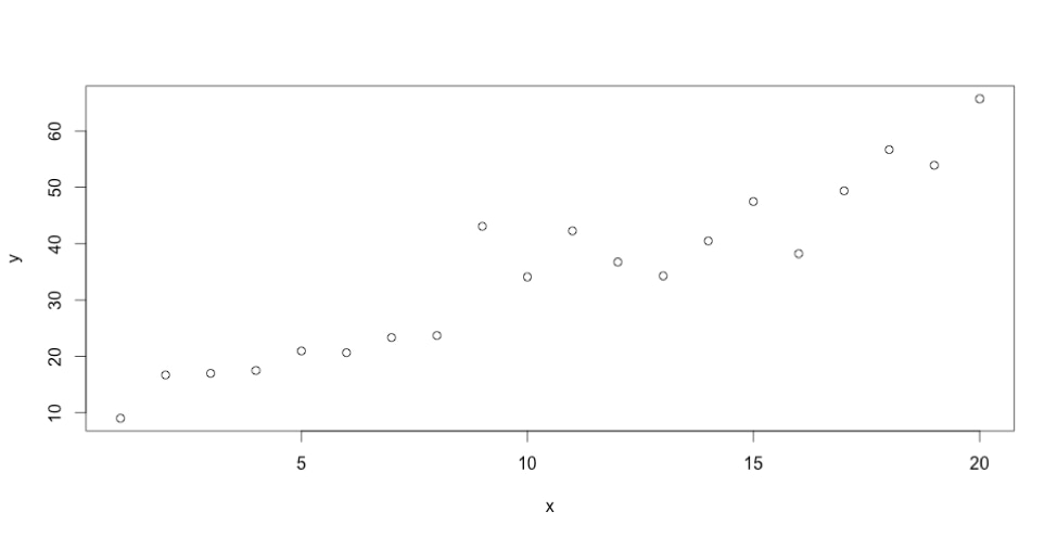

To illustrate the technique, I used R to generate a sample dataset. It’s very simple, just some points scattered around a sloped line by adding some randomness to the line. The magic slope and intercept values to keep in mind are 2.38 and 8.29. We’ll try to fit a line through the points, and see if we recover those parameters. Here’s how we generated the dataset:
x<-seq(1,20,1)
noise<-rnorm(20,0,5)y<-2.38*x+8.29 + noiseplot(x,y)

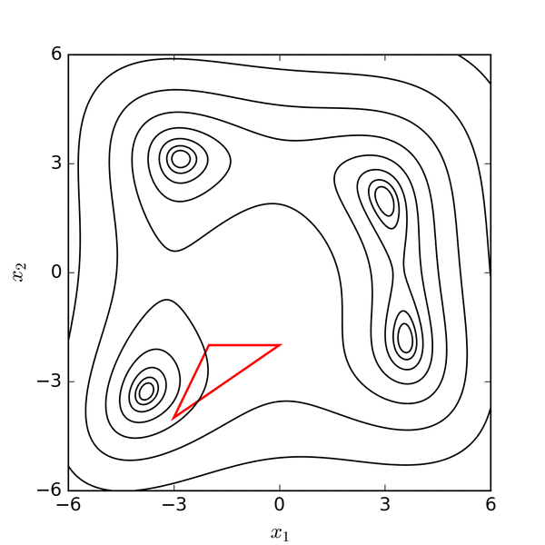

Now let’s see how to fit a line through these points with the Nelder-Mead optimization algorithm. Nelder-Mead works by drawing smaller and smaller areas with different values for the parameters, until they converge to a local minimum or maximum (hence the “optimization” terminology). Here’s what that looks like as an animation in 2D:
Source: https://commons.wikimedia.org/wiki/File:Nelder-Mead_Himmelblau.gif

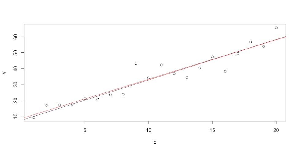

Those two values represent the optimized slope and intercept parameters. If you plot the points and a line with the optimized parameters, you get this:
Pretty good fit! Let’s see how that compares to ordinary least squares regression, as computed by R.
>lm (y~x)Call:lm(formula = y ~ x)Coefficients:(Intercept) x8.402 2.491

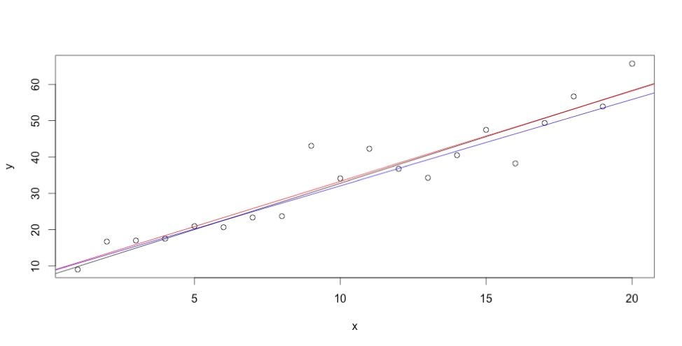

The least squares result is in red. Pretty close too! Finally, let me add the true line in blue with the slope and intercept values I used to generate the test dataset, 2.38 and 8.29.
