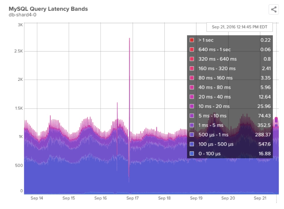

SolarWinds® Database Performance Monitor (DPM) recently released our Query Latency Bands chart, which combines both histograms and heat maps. Here’s what they look like:
You’ll notice that we use colors instead of vertical positioning for different latencies. Because we have stacked area metrics, this method proves to be a lot more detailed since you can see exactly how many elements went into each band. Glance up at the chart again: the combination of the chart with the color-coded key should make it easy to spot exactly where transitions between elements take place and to count how many elements contribute at each point on the x-axis.
Similarly, a color choice can make activity spikes jump out in a visceral way; note the big needles of color in the Sep 16 – Sep 17 timerange. The pinker hue digs deep into the purple and blue. Picking useful colors is especially important in this case, because interpreting this activity would be too confusing otherwise.

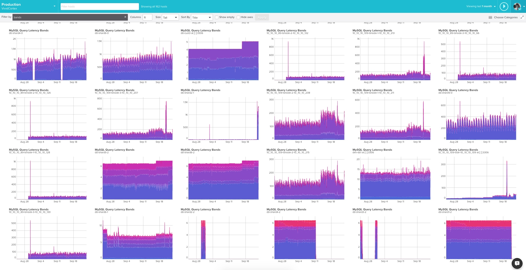

Likewise, having random colors would make it difficult to interpret the chart quickly. Once you figure out an effective, deliberate color spectrum, the colors become really helpful! For instance, we picked those colors to make it easy to pick out servers that have high latencies. Red areas are easy to spot! This is especially the case when you’re looking at a huge grid of these charts.
