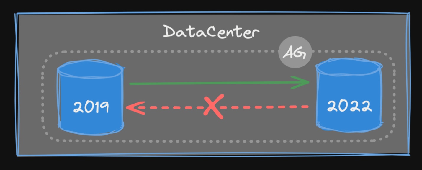

The other fast-track option for us would be to upgrade to SQL Server 2022 in our data center, which would give us a direct migration path to MI. But this means we’d have to plan out the upgrade in the data center before ever thinking about moving to the cloud. And adding a 2022 instance to an existing 2019 AG presents the same type of problem: we can’t test failing over to that instance as the primary while keeping the contingency of failing back.

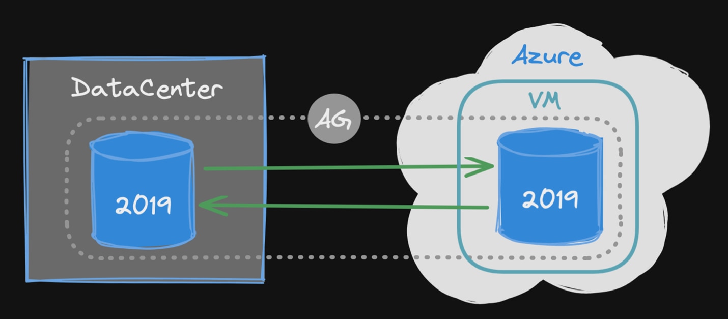

For our timeline, it makes more sense to move to Azure VMs in the short term, where we would put SQL Server 2019 instances and add them to our existing AGs. This approach would retain our ability to fail back to the data center if needed since it’s merely another on-premises instance in a new location.

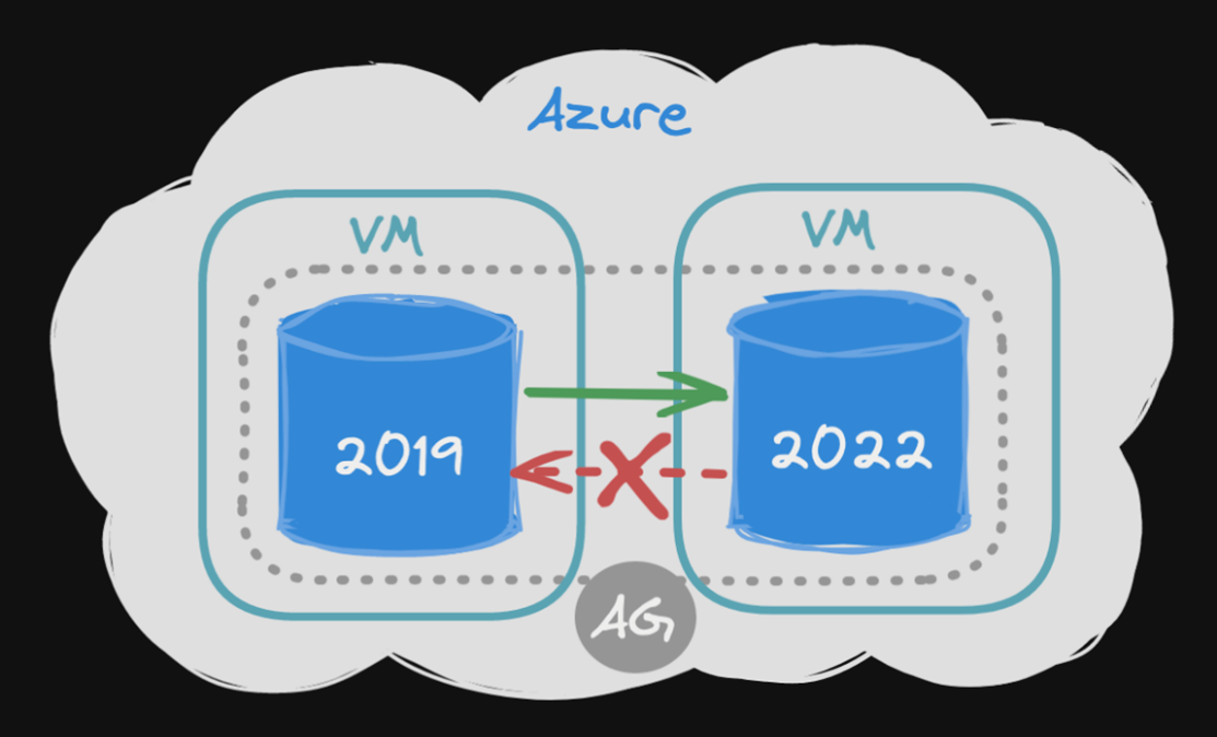

We would wait to add SQL Server 2022 to the mix until after we finish migrating to Azure VMs, and after all applications and services are certified to run there successfully. With the data center (and the potential need to fail back there) out of the picture, we can then start the task of upgrading to SQL Server 2022 in our Azure VMs. We could begin by adding a secondary, using it for read-only workloads, and eventually make it the primary (and phase out 2019 as we add additional 2022 instances).
In this scenario, we’d still have a point of no return, where the first time we switch to a 2022 primary would mean we can’t fail back to 2019. But once we’re fully in Azure, we’d be able to test all of our infrastructure independently and with no other differences, something we can’t do today. This testing would give us much greater confidence in our ability to upgrade our production workloads with less reliance on needing to fail back.

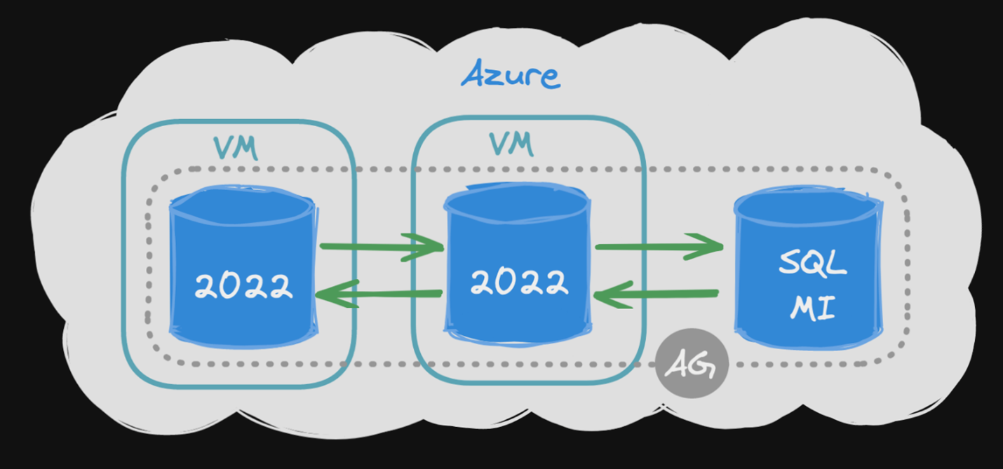

Sometime after this, we’d start the Managed Instance conversation. With multiple 2022 instances in place in Azure VMs, we could then introduce an MI secondary. We could begin with read-only workloads, as well as testing our applications and services against MI independently (like we plan to do with 2022). Now, though, we would have the full ability to fail back from MI to 2022, so there would no longer be a point of no return for this part of the evolution.
