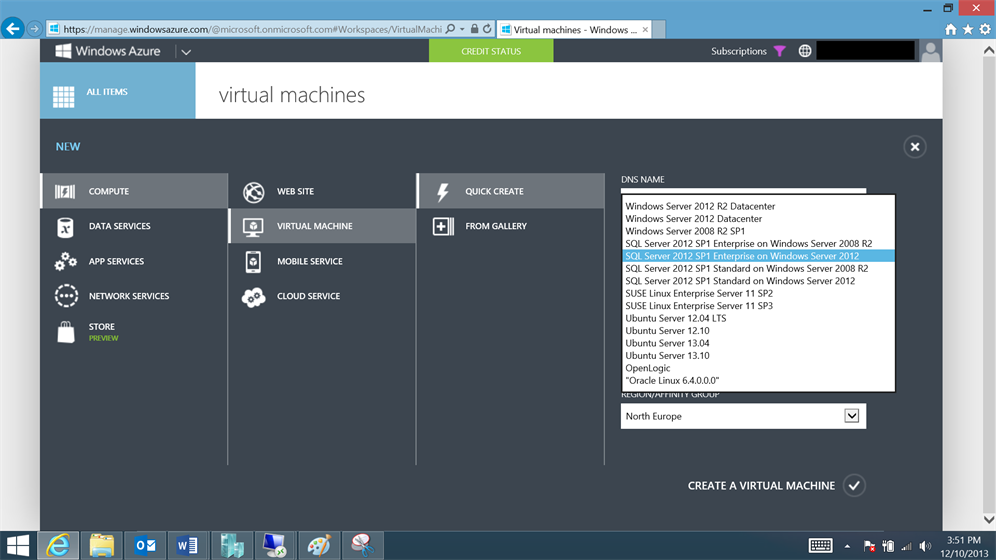

Create your VM
First we will create an Azure VM. Here I will choose the “Quick Create” option that has an image of SQL 2012 SP1 running on Windows Server 2012:

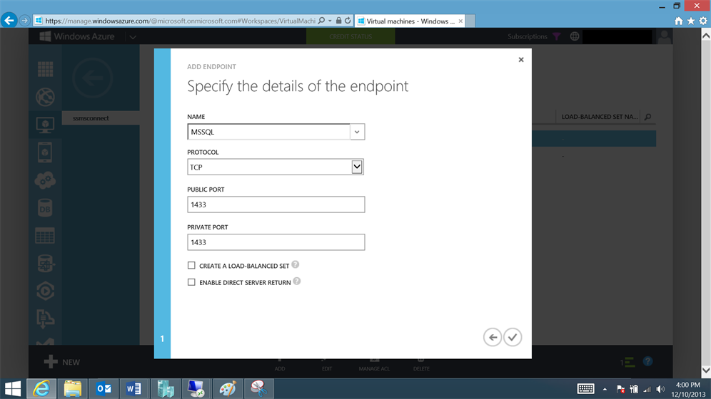

Open a port in the Azure management portal
Once the VM is created, you will need to open up a port to allow access to the instance of SQL Server. I’m going to stick with the default port of 1433 and create a new endpoint here:
Connect Azure VM SSMS 2

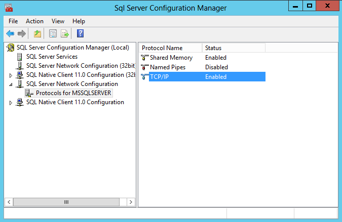

Here is where I also would advise you to take a moment to verify that SQL Server is enabled to use the TCP protocol:
Connect Azure VM SSMS 5

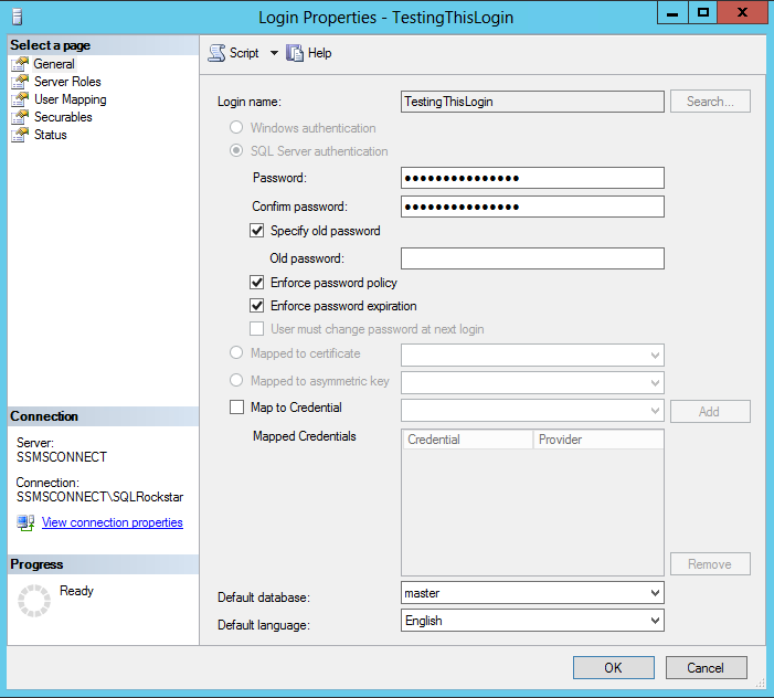

Next, we will configure SQL Server to use mixed mode authentication for the purpose of a simple example. Note that Windows Azure does support Active Directory at this time, so this may be an option for you.
We will change the security to ‘Mixed Mode’ and create a new SQL login:
Connect Azure VM SSMS 6

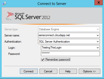

Connect
After a restart to the instance we should be able to connect:
Connect Azure VM SSMS 7

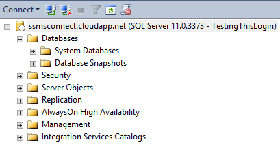

Voila!
Connect Azure VM SSMS 8
