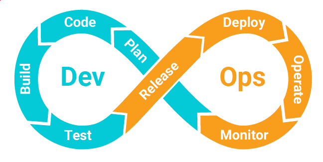

While deployment and monitoring tools alone don’t ensure a successful deployment, they certainly help. But it’s also important to build a DevOps culture of good communication, design reviews throughout development, and thorough testing. As shown in Figure 1, automated deployments are just one part of the DevOps lifecycle.
Figure 1: The DevOps lifecycle
You can decide where automation brings value in the cycle and create the automation in small chunks over time. Automated deployments can reduce risk and required effort, so you can deploy on a Friday if you need to. Their high ROI often makes them a great place to start automating with DevOps best practices in mind.
