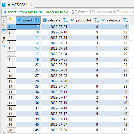

But I can also query each of the partition tables directly to see their values. Here I can see the sales072022 table only contains those rows where the saledate is in July of 2022.
select * from sales072022 order by saleid;
Sales July 2022 Figure 2

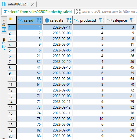

Also, notice there’s no overlap between the three partitions of the table. The saleid is unique and monotonically increasing.
select * from sales092022 order by saleid;
Sales Sept 2022 Figure 4

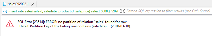

PostgreSQL will happily let me know if I try to insert a record having a saledate not falling into the range of any of the partitions I declared earlier:
insert into sales (saleid, saledate, productid, saleprice)
select 50000, '2020-03-18', 6, 600;
Partition Error Figure 5

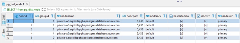

To view the number of nodes in my Hyperscale server group, I can query the pg_dist_node system view. Here we see I have four worker nodes and one coordinator node.
SELECT * from pg_dist_node;
Worker Nodes Figure 7
