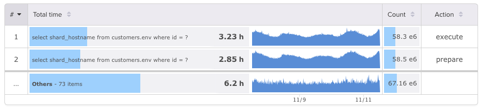

Yesterday I found just such an example in our central shard lookup database, which is a hotspot for our API traffic. Every API access first has to find the database server that stores the data for the customer environment being accessed. Here’s a screenshot of the query:
Production_total_time
I’m ranking Top Queries by total time consumed, and limiting to the top two queries. You can see the top two queries appear to be the same query. But if you look at the rightmost column, you’ll notice  the action – execute and prepare – is different.
The implication is clear. The top query on this database server is being essentially doubled in impact! Not only that, but if you look at the count, you can see it’s prepared more times than it’s executed, which means sometimes it’s prepared and then not even executed. This is an artifact of Go’s database/sql package and the way it treats prepared statements behind the scenes.
If we change from a prepared statement to a plaintext query here, we’ll reduce round-trips on the network and free up a lot of resources in the database server. Simple queries like this don’t benefit from being prepared. We’ll handle the security aspect of this query by validating input (which our API framework already does for us).

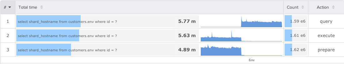

You can see the results of replacing the prepared statement below. Making this change resulted in nearly a 30% drop in load on our shard lookup server. The savings really cannot be overstated here; this query is run every time we read or write data from a customer’s environment, so this optimization will make a big difference.
