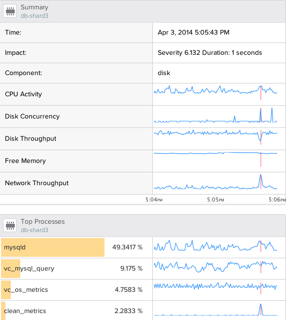

The best way to show a quick high-level summary of these events is to use screenshots of our fault analysis dashboard. By clicking on the fault event, you get a diagnostic summary. Here’s a snippet of the first one.
Examples_Of_Faults
This is a fault in the disk subsystem. We get a lot of these because of EBS volume stalls, but typically we don’t care. In this case, however, the fault occurred because of the abusive activity of a program called clean-metrics. This background worker program helps us clean up some data that’s become orphaned as old data is purged. We had a problem with this job on one server, and it got behind in its work. When it ran again, it deleted way too much data in one big chunk, and that overloaded the disk. This is an absolute smoking gun. You can see it impacting the network, piling up hundreds of pending IO requests, and stalling IO requests to the disk, all at the same time.

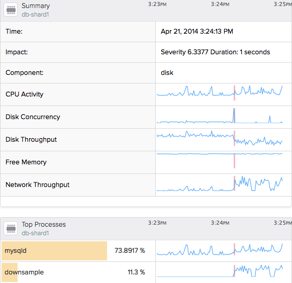

Here’s another example:
summary
This is also a job that got behind and had too much work to do, in this case a metrics down sampling program. You can again see it impacting the disk concurrency and throughput, and the network throughput. Notice that the fault itself only lasted about a second, although the program ran for much longer than that. That’s because the program’s normal work takes a long time, and doesn’t constitute a fault. What is a fault is when the system gets stalled by the initial “get ready to do work” query, which blocked a lot of activity on the system.
In both cases, these programs were written to do as much work as was available, instead of doing the work in small batches. Solving these problems is pretty easy: do things in small bites, not a giant gulp.
What’s interesting is that there wasn’t really a noticeable impact to our systems. No downtime, no serious problems. But we were able to catch these potential problems while they were very small, before humans would ever be able to notice them, and prevent them from turning into major incidents.
