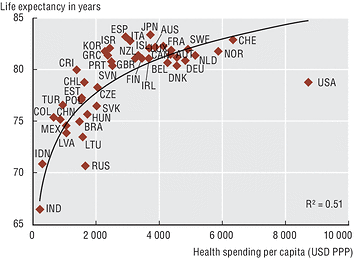

Here’s an example of a trendline on a chart. This one comes from an Excel file provided with an OECD dataset on health statistics (source, data).
Whoever created the scatterplot chart of health spending per capita versus life expectancy at birth is asserting, probably unintentionally, that the relationship is logarithmic. That is, as a country spends more on healthcare per capita, the return on investment in lifespan grows logarithmically.
Is the addition of a trendline really a claim that the data follows the model that generates the trendline? Yes, it really is, although most people don’t think of it that way. Trendlines are used to explain datasets and to forecast how they’ll behave beyond the observable limits. Even the Excel help articles on trendlines are explicit about this; they are titled “Predictdata trends” and include references to projections, e.g. “a trendline is used to depict trends in your existing data or forecasts of future data.”
Excel permits only a few kinds of trendlines, and the only type that matches the curve shown in the above chart is the logarithmic one, y=c ln(x) + b.
Although most people probably use trendlines without intending to assert that the data follows the trendline’s model, there’s really no point to adding a trendline otherwise. And in datasets such as the one shown, there’s no way to know that lifespan is a logarithmic function of spending. This is chartjunk, pure and simple.
In other words, if you don’t think the data is logarithmic, don’t fit a logarithmic curve to it.
The logarithmic curve is also a very poor prediction of the data, with the R-squared value of 51%. That’s very low, so low that it’s not worth showing. What is the purpose of adding a trendline with such a poor fit? What was the person thinking who created this chart? I’d guess they were not very experienced in statistics.

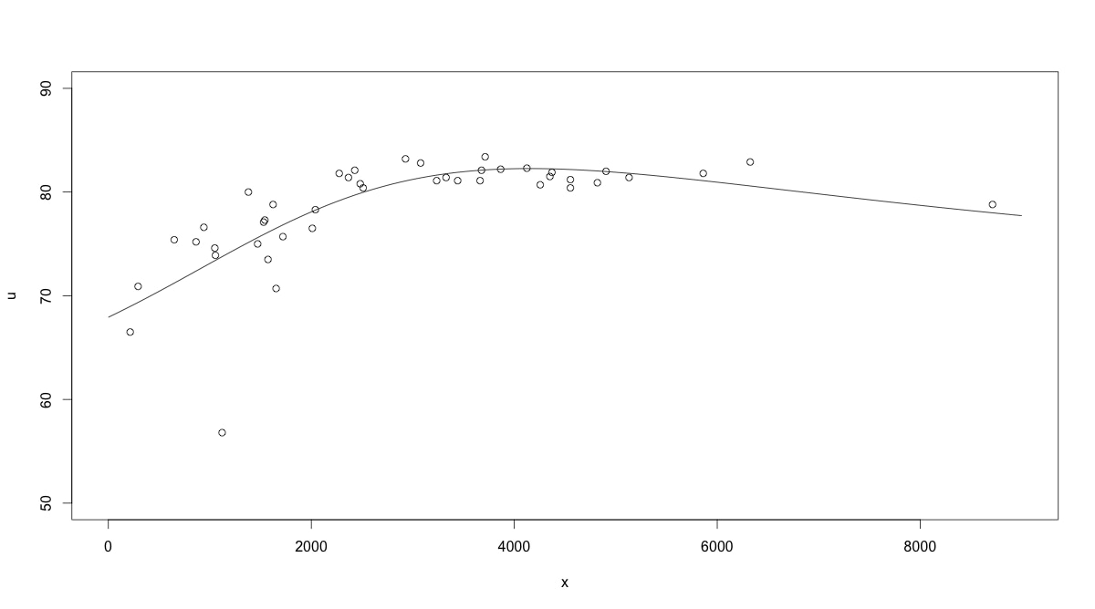

In fact, if I’m going to fit any data to this curve, I think it looks more like the USL shifted vertically than anything else:
universal scalability law
My eye is trained to see the USL everywhere at this point, whether it’s real or not (all meaning has pattern, not all pattern has meaning). Let’s see how well that fits and if it’s a better predictor. Here’s a plot:
oecd health data replotted
The R-squared value is now 99.83%. That’s much better! This must mean the USL is the correct model to predict lifespan as a function of healthcare spending, right? Given that it’s a model of system scalability, that’s an odd result.
Notice something? The original plot from the OECD actually hides some of the data! Those sneaky people! They changed the axis range to hide South Africa. Look, if I change the vertical axis range, a new outlier appears.
Health Data Replotted to Show South Africa
