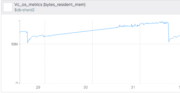

First – what does such a problem look like? Here’s a screenshot of what happened when I introduced one of these bugs into our operating system metrics agent:
The ticks on the time-scale are in days. The memory growth is slow enough that even if you watch the agent over a few hours after a new release, you might not see it. The sharp jumps downwards are when this agent was released and restarted. You can see that at first its memory usage grows a bit, and then it settles down; this is what we’re used to, and the steady climb only becomes clear after most of a day has passed.
