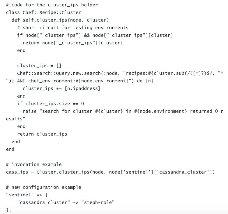

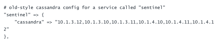

Previously, we had used simple lists of IP addresses stored in Chef attributes; the cluster grew infrequently, so it was easy enough to add an IP to a bunch of lists, then let Chef push the new lists out to clients. It was definitely technical debt waiting for an opportunity. This upgrade offered just the right excuse.
We wrote a simple helper function called `cluster_ips`. It takes two arguments: the environment (e.g. production, staging, etc) and the cluster. It returns the IP addresses of all the nodes returned by the corresponding Chef Search query. We then replaced all the hard-coded IP lists with calls to `cluster_ips`. Instead of a list of IPs, every service’s Chef definition would now contain an attribute to specify the name of the Cassandra cluster to look up using `cluster_ips`. Initially, they were all set to `cassandra-role`. We would switch them to `steph-role` one at a time.
During the upgrade, the cluster would straddle two “roles” until everything switched from `cassandra-role` to `steph-role`. We could switch the lookup to `steph-role` for some services early in the upgrade to make sure everything still worked well when communicating with the new version of Cassandra and be able to switch back in a hurry if things went awry.

With the above changes in place, we were ready to go! We switched one of our staging Cassandra nodes to `steph-role` and ran Chef on it. Clients promptly stopped sending traffic to it because it disappeared from the search result for `cassandra-role`, but it kept serving reads as part of requests coordinated by the 1.2 nodes.

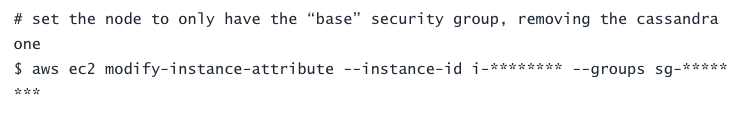

The firewall is a very useful tool when working with distributed systems. It can unequivocally cut off communication between nodes in a cluster. This is extremely useful both when testing the failure modes of such a system and when trying to limit the potential impact of a bad cluster member. Since we use EC2, we get to use Security Groups for this purpose, making it very easy to apply and remove rule sets. We have a SG called `prod-cassandra` which opens only Cassandra specific ports to clients and other nodes in the same SG. Removing it from a node effectively cuts it off from the rest of the cluster and from client traffic.
Before upgrading our production node, we did just that.
This allows us to bring the node up cut off from its peers and verify that it is behaving sanely: it thinks it’s part of the right cluster, has the correct data, is otherwise properly configured, etc. It’s also just reassuring to see a distributed database properly acting out its failure modes. We don’t do as many “game days” as we’d like, so this was a nice excuse to see what Cassandra actually did in this situation.

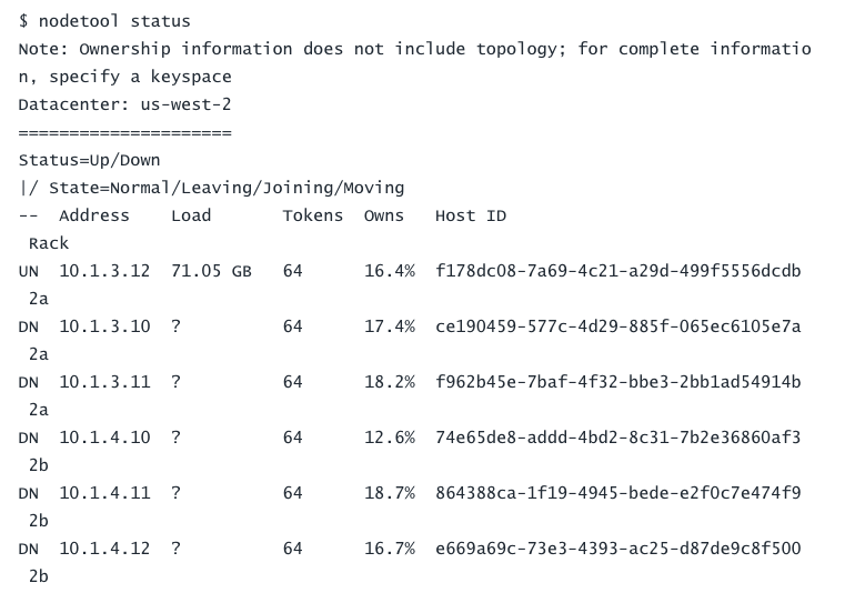

We proceeded to switch the node’s Chef run list from `cassandra-role` to `steph-role`, causing Chef’s next run to upgrade it to Cassandra 2.0. At this point we discovered a critical difference between staging and production that we had previously missed: production hosts store their data files on two volumes. The version of the community cookbook we had been using did not support this, so we had to stop and upgrade to a later release. The cookbook had since changed names, so some dependency wrangling was required. Fortunately, we use Test Kitchen to test and validate all our roles, so it didn’t take very long.
After that brief exciting detour, the next Chef run did exactly what it was supposed to. The node came online with the memory of a 6 node cluster to which it could no longer communicate, with the correct token ring ownership and the correct amount of data. It was able to respond to queries with consistency level `ONE`.

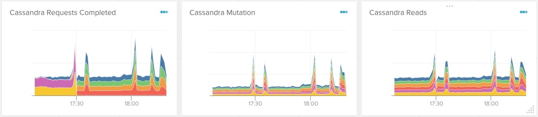

We did one more node using the same pattern. When we had two fully operational 2.0 nodes (enough to handle part of the client traffic), we switched some of our less critical, lower throughput services to use them as clients. All automated checks and manual QA continued to come back positive. As we continued upgrading nodes, we ended up in a position where only 2 nodes were left on the 1.2 side of the fence, still performing all the client traffic for our busiest services. It was time to cut those over to the 2.0 nodes. This created some very cool “graph art”:
cassandra graphs
You can see that internally, Cassandra was coordinating the requests evenly around the cluster, but the client traffic was predominantly going to the two pre-upgrade nodes. Something about seeing the actions you’re taking re-told in graphs is magical.
