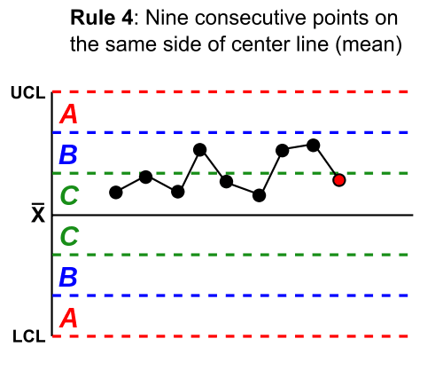

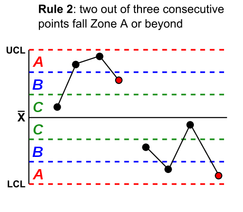

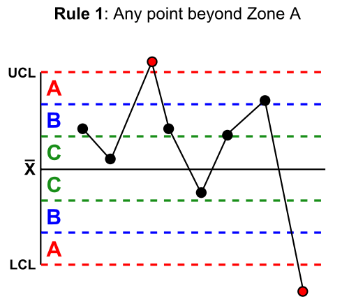

To achieve this, the rules divide the chart into zones, measured in units of standard deviation (σ) between the centerline and control limits, as 1, 2, and 3 standard deviations from the mean. In the following examples, the red line is 3 standard deviations, the blue line is 2 standard deviations, and the green line is 1 standard deviation, although these can vary based on business needs.
The Western Electric rules are as follows (image credits to Wikipedia):
point_beyond_Zone_A
two_out_of_three_consecutive_points
four_out_of_three_consecutive_points
nine_out_of_three_consecutive_points
