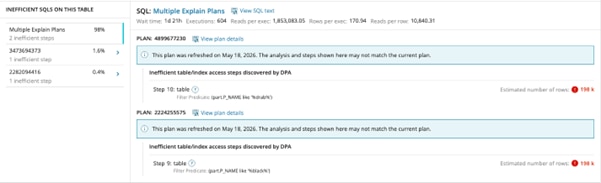

Execution plans can be difficult to analyze manually, especially when you’re trying to determine which part of the plan is actually driving unnecessary work. To help, DPA identifies inefficient producer steps in the explain plan using a proprietary algorithm.
In DPA, producer steps are the plan steps that read data for later processing by downstream consumer steps. In practice, these are often full table scans or full index scans that examine far more rows than the query ultimately needs.
Even when a later step such as a sort appears expensive, that cost is often a downstream effect of a producer step reading too much data up front. That’s why DPA surfaces inefficient producer steps as a useful starting point for tuning.
Instead of manually dissecting the full plan, DBAs can quickly see where the engine is doing disproportionate work. From there, they can evaluate whether the right fix is a new index, a modified index, updated statistics, or a query rewrite.
If an inefficient producer step is reading far more rows than the query ultimately needs, downstream operations such as joins, sorts, and aggregations have to process more data than necessary. Therefore, DPA highlights these steps so DBAs can focus first on the part of the plan most likely to be driving excess work.

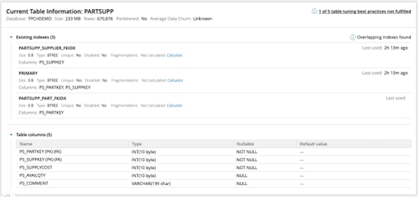

If a table is read-heavy but write-light, a covering index can be a strong option. However, if that table is subject to massive write pressure, adding an index increases the overhead for every INSERT, UPDATE, and DELETE.
DPA calculates Table Churn, the volume of data modification activity on the table.

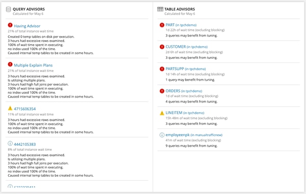

The Table Tuning Advisor visualizes this churn alongside existing indexes and related table/index context.
For the DBA: This provides the safety verification needed to approve changes. You can see immediately if a table is too volatile to support additional indexing without risking write-latency regression.
For the Developer: This validates query design. It forces a conversation about why a high-churn table is being queried inefficiently and whether the schema supports the access pattern.

What does Table Tuning Advisor do?
Table Tuning Advisor helps identify tables with inefficient workloads by aggregating information about the table, the inefficient queries that ran against it, and any existing indexes.
